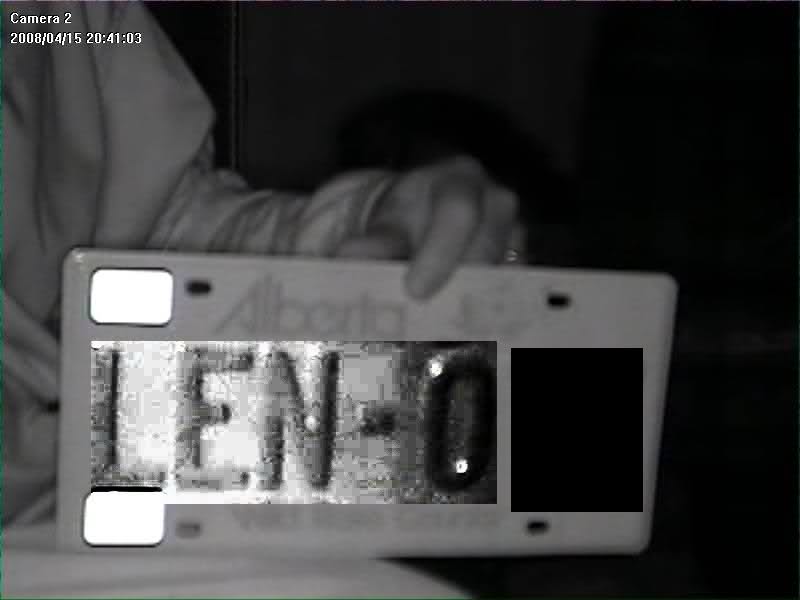

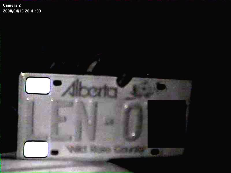

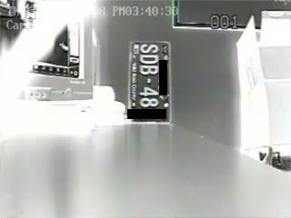

ak357 0 Posted January 20, 2010 rory said: cglaeser said: rory said: What kind of IR are you using, also what type of camera? Maybe its a different red then on the plates we have here. I don't think it's the IR or the camera. I'm guessing it's the color. I have an Axis 223M and RayMax Fusion 50. A very dark blue sweatshirt that I own appears bright white and much brighter than a medium pair of blue jeans. I've seen various dark deep colors reflect the IR very brightly and while some lighter colors don't reflect much IR. Best, Christopher Yeah but thats why we pay extra for the Reg cameras. .. its not your standard IR, its totally different build. not sure about the reg bullet though. Id have to check but im pretty sure we had no problems with any color plate here. Its been a while though. "Red" IR against red number I guess I don't expect lots reflection that why I tried to invert and get not bad results unless u guys have some other ideas Share this post Link to post Share on other sites
rory 0 Posted January 20, 2010 I dont know .. I have no plates like that to test right now .. here is that same image you posted though, equalized the number section: Share this post Link to post Share on other sites
rory 0 Posted January 20, 2010 here is the image you posted, with contrast turned up: Share this post Link to post Share on other sites
ak357 0 Posted January 20, 2010 rory said: here is the image you posted, with contrast turned up: thx but I have done this before You know as well as me in real life we need to capture as is Customers don't like to play Share this post Link to post Share on other sites
