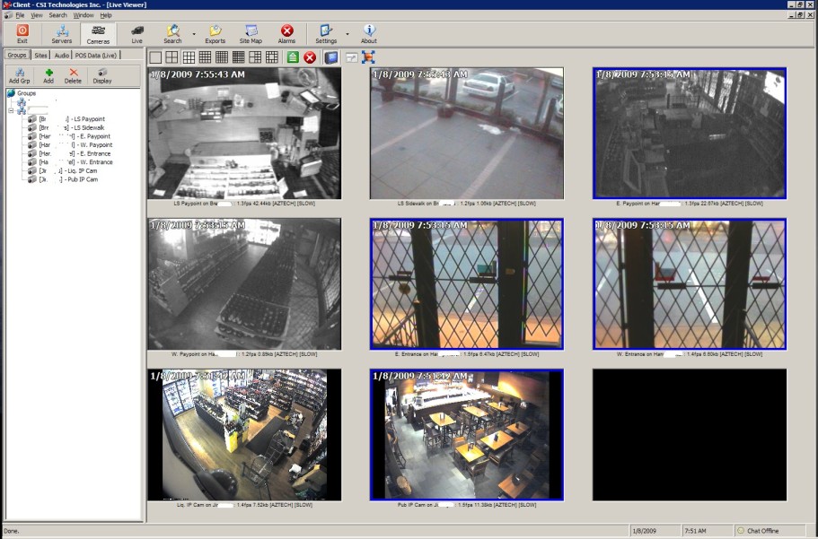

Soundy 1 Posted January 19, 2010 Vigil will do much (most) of what you're looking for, including a client that can connect to and view multiple sites on a single screen. I don't know about doing it on four screens - you could probably expand the single client view across four monitors with the appropriate video card, or just use one really big monitor. It will also record in a higher quality than it streams at, and can adjust the stream for your available bandwidth. Keep in mind, at some point, the downstream speed at your monitor station will start to become a bottleneck - eight simultaneous streams at 384k each is 3Mbps. You'll want to make sure your station has AT LEAST that much bandwidth (factor in other regular internet traffic as well). Share this post Link to post Share on other sites

Soundy 1 Posted January 20, 2010 Is Vigil an actual DVR system, or just the client software? Full-on PC-based DVR/NVR system - you can buy just the software, the card and software, or the complete system. The client software is included free. There's an excellent central-management/health-monitor package with it as well, that works on a 30-day trial and will let you actively monitor all your sites and email alerts to you if anything goes wrong. A bit off-topic, but is there such a device (or software for PC-based DVRs) that records and streams in an open standard format such that I can write my own client? I played around with zoneminder but am looking for something more robust (and not too happy with mjpeg streaming). Thanks Depends on how you define "open standard format". Vigil can record in both MJPEG and MPEG-4 (and H.264, I think, with some cards). AFAIK, the specs/SDKs for all are readily available. Share this post Link to post Share on other sites
