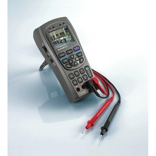

hardwired 0 Posted January 22, 2010 One of our guys swears by the Rapport 337 tester it is nice, monitor, multimeter, signal generator, and PTZ controller... I spend more time using this one, the Test-Um NT750 kit. Share this post Link to post Share on other sites
Soundy 1 Posted January 22, 2010 One of our guys swears by the Rapport 337 tester it is nice, monitor, multimeter, signal generator, and PTZ controller... I've seen those, I'd love one... $$$$ tho! I spend more time using this one, the Test-Um NT750 kit. Looks pretty similar to mine, but with the signal-tracer wand... and a bigger screen on the main unit? More graphic mapping, or just more info display? The TP600 has tone-generator function as well, which I've used with my regular fox-and-hound kit's wand. Share this post Link to post Share on other sites

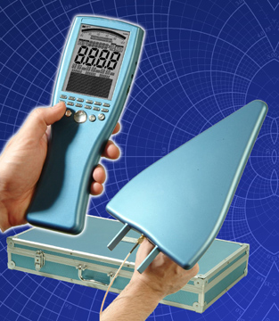

hardwired 0 Posted January 22, 2010 Yeah, the Rapport unit is pricey, but it's sort of the Swiss army knife of testers, a lot of times you don't need much else... As far a the Test-Um NT750, it has a display that adds a few good features, like showing DHCP results, PoE power presence and voltage, flashing the link light on a switch it's connected to, and two of the units can ping each other... I had the kit you have first (which does work fine, too), and kicked it down to one of the install guys and got the 750 kit.. Actually, my most recent test equipment purchases have been the Ubiquiti AirView2 and 9 cheapie spectrum analyzers, considering how much wireless I've been doing recently. Thinking about getting the Aaronia HF-6080 Handheld Spectrum Analyzer, But it's over 2K.. Not bad for a spectrum analyzer, but probably not in the budget for a while... Share this post Link to post Share on other sites

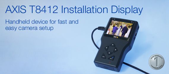

thewireguys 3 Posted January 23, 2010 I use both of these every day for every job. http://www.jdsu.com/products/communications-test-measurement/products/a-z-product-list/validator.html http://www.flukenetworks.com/fnet/en-us/products/IntelliTone+Toner+and+Probe/Overview.htm?wbc_purpose=Basic&WBCMODE=PresentationUn%2cPresentationUnsupportAndDownloadsAboutUssupportanddownloads This is next on my list. http://www.axis.com/products/cam_t8412/index.htm Share this post Link to post Share on other sites
