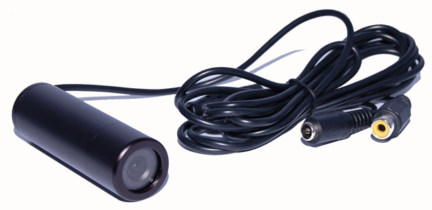

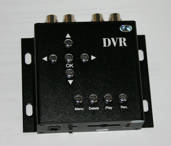

She won't be alerted by new security lights but will almost certainly notice cameras. There are also doorview cameras that replace the peep hole scope in your door, or you can make your own with a 19mm hole through the door and fixing in a small bullet camera with wide angle lens. You could run to it using cat5 cable and hide a recording device nearby or get one or two of those DVRs meant for cars that record onto SD card Once the issue is over these can be installed in your vehicles as accident cams
