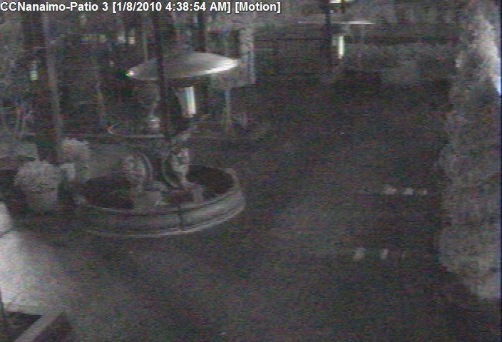

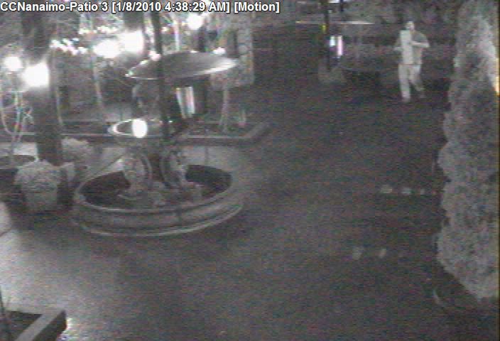

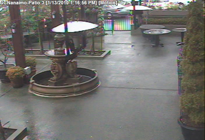

Soundy 1 Posted January 25, 2010 We just put in a number of the VCM-20VF models in a restaurant... I can't speak for how they handle backlighting (we still use a CW484 for the front door), but they work great in low light. Here's the daytime shot (note that we only had a chance to get a rough focus before the rain started and we had to close them up, so they're not as sharp as they should be): And then at night - one with the patio lighting (which is VERY dim in itself), and one with only a bit of street lighting and lights from inside the dining room filtering in (basically dark enough I was tripping over things): Share this post Link to post Share on other sites

bricor 0 Posted January 25, 2010 That color pic looks terrible IMO. Is that due to the camera, the dvr or what? Share this post Link to post Share on other sites
Soundy 1 Posted January 25, 2010 "Here's the daytime shot (note that we only had a chance to get a rough focus before the rain started and we had to close them up, so they're not as sharp as they should be)" Share this post Link to post Share on other sites
pearlite TL 0 Posted January 25, 2010 he did say that it wasnt completely focused due to the rain... but i have to say i use a decent DVR along with these cameras and love them. Share this post Link to post Share on other sites
rory 0 Posted January 25, 2010 Soundy said: "Here's the daytime shot (note that we only had a chance to get a rough focus before the rain started and we had to close them up, so they're not as sharp as they should be)" A tip: use a viewfinder to get the exact view you want prior to installation, then focus the camera in a controlled environment, so at the location you just have to mount and adjust view. I understand this cannot always be done, especially for far FOVs, but in many cases it will work the best. One is then not restricted to using a small LCD to focus which does not give a good focus, or a Focus meter which needs to be done at a certain time of the day and costs alot of money. Share this post Link to post Share on other sites

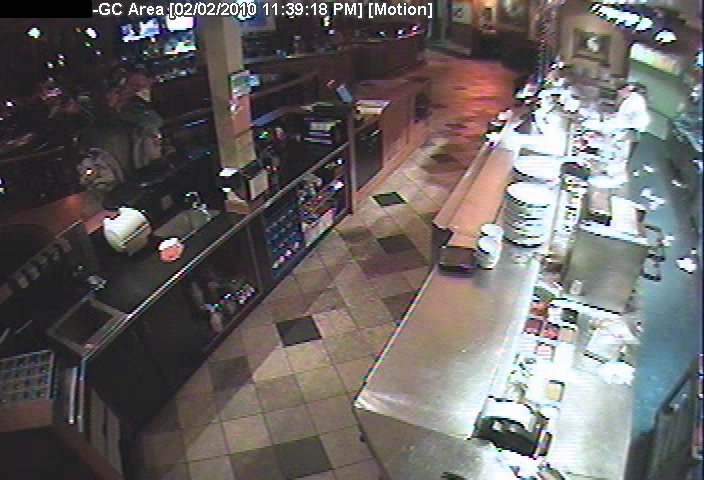

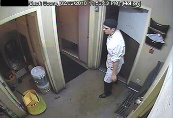

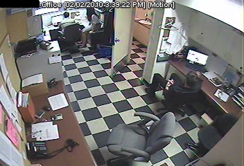

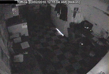

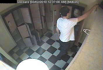

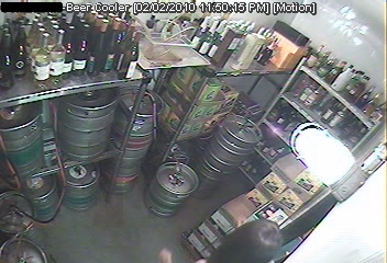

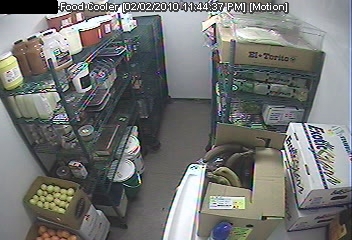

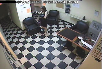

Soundy 1 Posted February 3, 2010 Okay, got those pics from the other VCM-20VFs. Same site, same DVR... I think I know what part of the problem is now with those patio cams, though: we used some ultra-cheap baluns (because that was all we could get on short notice), and the patio cams are a good 4-5 times the distance of any of the others (on the order of 250-300'). Now I'm thinking that the cheap baluns may not be faring so well on the longer runs (some of these are only about 30-40'). The shorter runs, however, seem to be just dandy: Share this post Link to post Share on other sites
bantham1 0 Posted February 3, 2010 Thanks Soundy for the pics. These pics look pretty good (baluns/cable) must be the problem on outdoor cams. Do you think these cams are in the same league as the pany's? Share this post Link to post Share on other sites
Soundy 1 Posted February 3, 2010 Normal lighting, I'd say they're pretty close... I haven't tried them with any sort of severe backlighting yet, though, so I can't say how they'll compare to the SuperDynamic function. Share this post Link to post Share on other sites
ak357 0 Posted February 3, 2010 Soundy said: Normal lighting, I'd say they're pretty close... I haven't tried them with any sort of severe backlighting yet, though, so I can't say how they'll compare to the SuperDynamic function. Last pix (D1 res) would be nice to see at CIF res to have equal comparison also is this Vigil or ? Share this post Link to post Share on other sites
rory 0 Posted February 3, 2010 ak357 said: Last pix (D1 res) would be nice to see at CIF res that looks like its already CIF and just blown up? Or do my eyes deceive me, why is everything on the right half of the image a blur? Share this post Link to post Share on other sites
