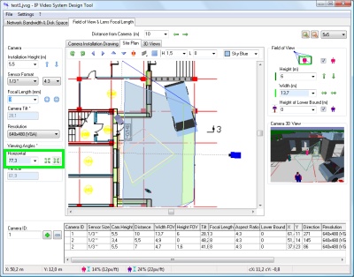

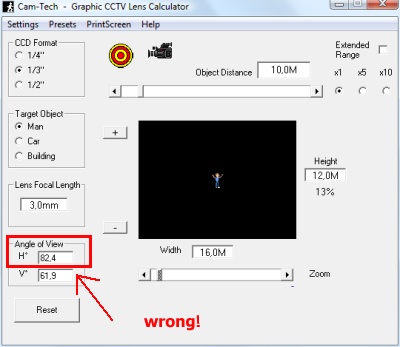

ipman 0 Posted February 14, 2010 I downloaded this calculator and found an error in the horizontal angle of view calculation. It seems for any given parameters in this calculator horizontal angle = vertical * 4/3. This is wrong! In fact the correct formula for sensor with aspect ratio 4:3 is little bit more complicated: Horizontal Angle = 2 arcsin( sin(VerticalAngle/2) * 4 / 3) For example for camera with sensor format 1/3" and focal length 3mm all other tools show Vertical angle = 61.9; Horizontal Angle = 77.3 in this CamTech calculator Vertical angle = 61.9; Horizontal Angle = 82.4 Please click on images to enlarge. Correct example (IP Video System Design Tool): Share this post Link to post Share on other sites

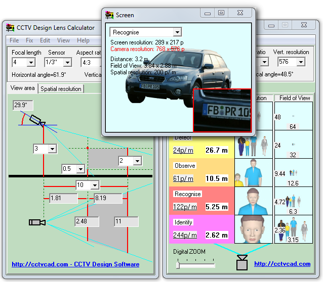

Stanislav 0 Posted March 30, 2012 See also CCTV Design Lens Calculator. Together with usual functions of Lens Calculators, it offers several new tools, such as calculating field of view projections in 3D, simulating camera resolution using photos and images including megapixel cameras up to hundreds of megapixels and other. CCTV Design Lens Calculator is free Share this post Link to post Share on other sites

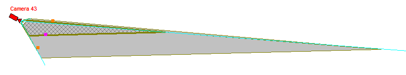

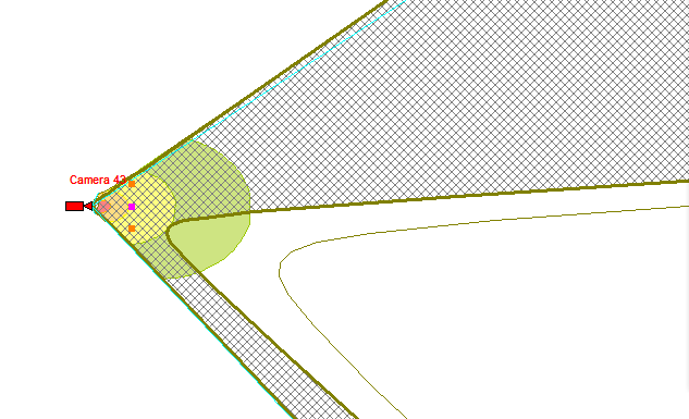

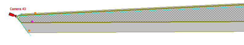

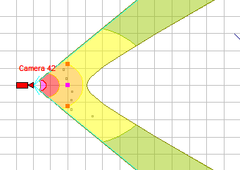

Stanislav 0 Posted October 4, 2014 What do you think about such Fields of view? What lens calculator can calculate them correctly? Share this post Link to post Share on other sites

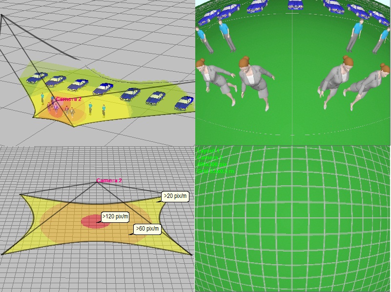

Stanislav 0 Posted May 18, 2015 Today, all Lens calculators and CCTV design software (except VideoCAD Professional 8.1) calculate view angles of wide angle lenses with errors, because they do not take into account the Lens distortion. About Lens Distortion Additional errors are expected in calculating the view angles of modern cameras because of the image sensor size is considered in inches from the time of vidicons not taking into account existence of the modern image sensors with aspect ratios different from 4:3 and/or using not whole pixel area for scanning. See Specifying active area size of the image sensor Share this post Link to post Share on other sites
