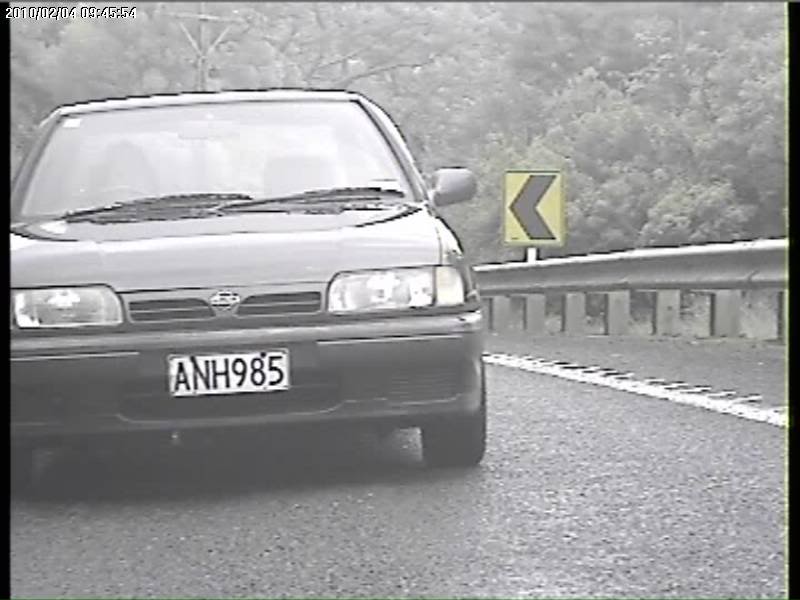

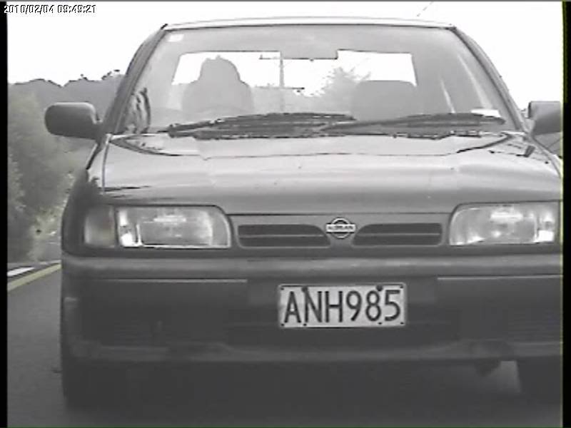

Soundy 1 Posted February 9, 2010 I dunno, those pictures look pretty good to me, all things considered. You'd have a hard time getting more detail than that without going to a megapixel camera. "Refresh rate" on an analog video camera is fixed - 30fps for NTSC, 25fps for PAL... perhaps you mean shutter speed? Share this post Link to post Share on other sites

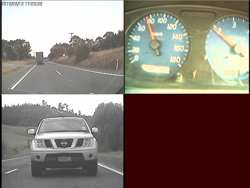

tweak'e 0 Posted February 10, 2010 ~3-4m range ie one car length. around 1m at a guess. pics off my cheap camera setup. (hope the pics work as photobucket is down at the mo) 3-4 car lengths starts getting tricky unless you have a really good camera. Share this post Link to post Share on other sites
mituc 0 Posted February 10, 2010 Ok, your resolution is far better than mine and I can tell that only by looking at the license plate of that nissan navara/patrol/whatever which is at 7-8 meters behind you. I understand that for the rear you have a ordinary reverse camera + better lenses, and because of the lenses means that the whole thing is a bit bigger than what I want. So do you think that some lenses like these: http://www.yotang.com/waterproof-wired-surveillance-camera-adjustable-wide-lens-wholesale_p4137 would do?... eventually combined with a higher resolution camera? Or these: http://www.yotang.com/variable-focal-length-lens-for-cs-mount-cameras-wholesale_p4103 ? My question about another web sites where I could find what I'm looking for still stands, so if you can give me any hints I'd appreciate it. Share this post Link to post Share on other sites
tweak'e 0 Posted February 10, 2010 mituc said: Ok, your resolution is far better than mine and I can tell that only by looking at the license plate of that nissan navara/patrol/whatever which is at 7-8 meters behind you. I understand that for the rear you have a ordinary reverse camera + better lenses, and because of the lenses means that the whole thing is a bit bigger than what I want. ...... the white nissan navara D40 is actually 4-5m, i can tell via the blind spot in my mirrors. the pics always seam to look like its a lot further away than it is. thats only a no name 420 line camera with 8mm board lens. i would have to dig through the footage to find one at 10-15m, but number plate starts becoming hard to read at that distance. granted a better camera will see it but size of number plate gets really small in the pic. but a wider angle lens will make it worse. so bit of a trade off. Share this post Link to post Share on other sites
