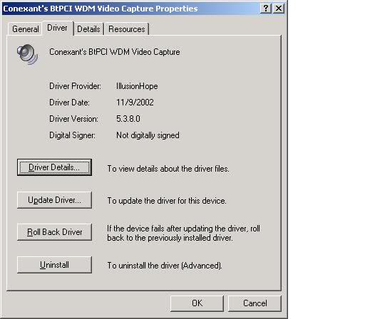

Well I am using Universal WDM Video Capture Driver from http://www.fgeng.com/drivers.htm My uncle gave me the card which was from his works upgrade.
Setup as Conexant Bt878 NTSC XEVK , I am in the UK which is PAL (states being NTSC?)

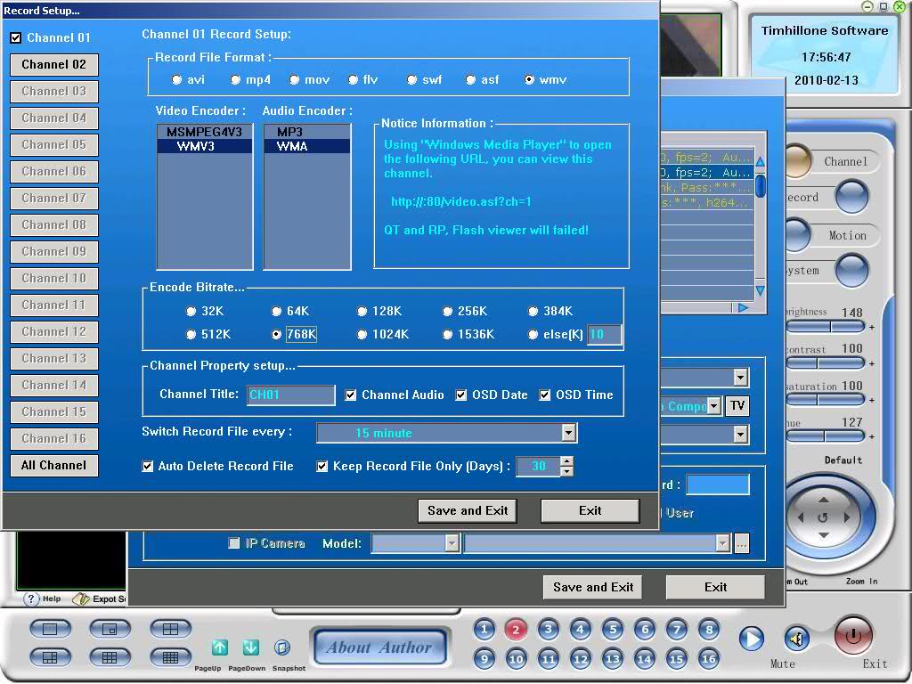

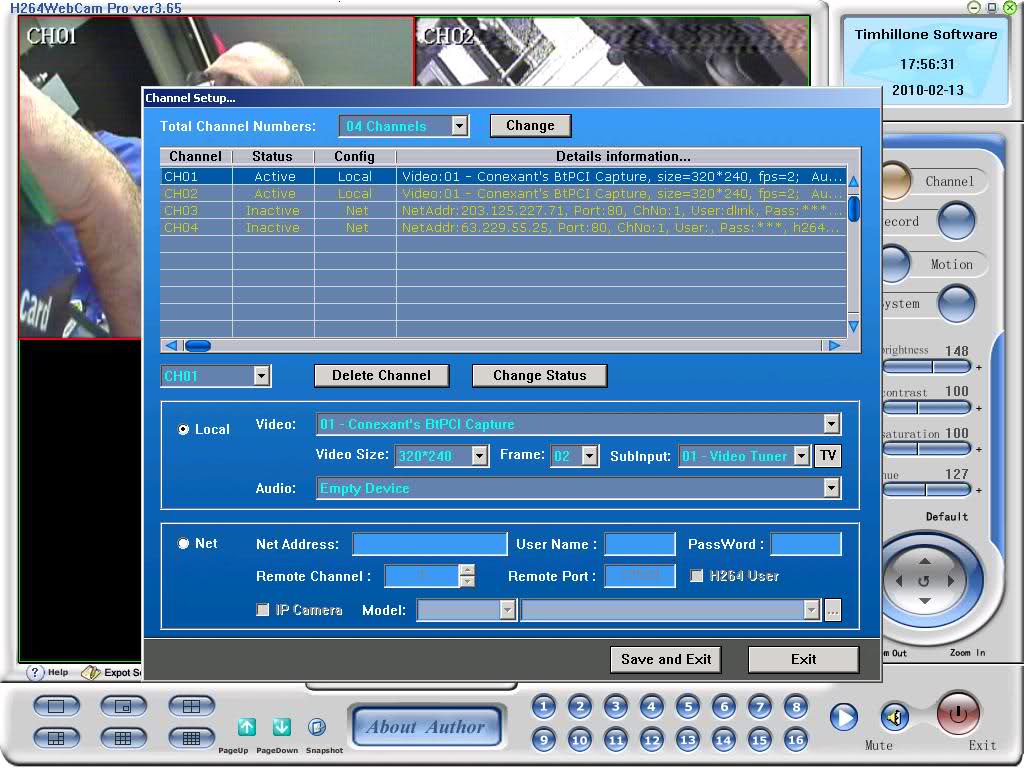

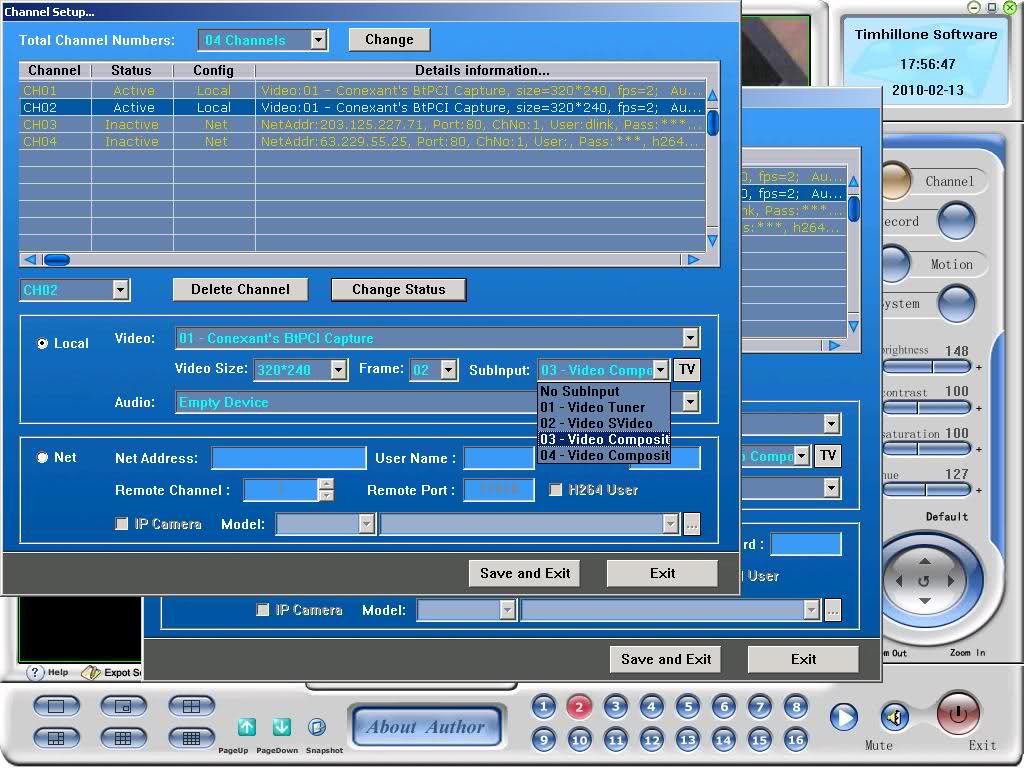

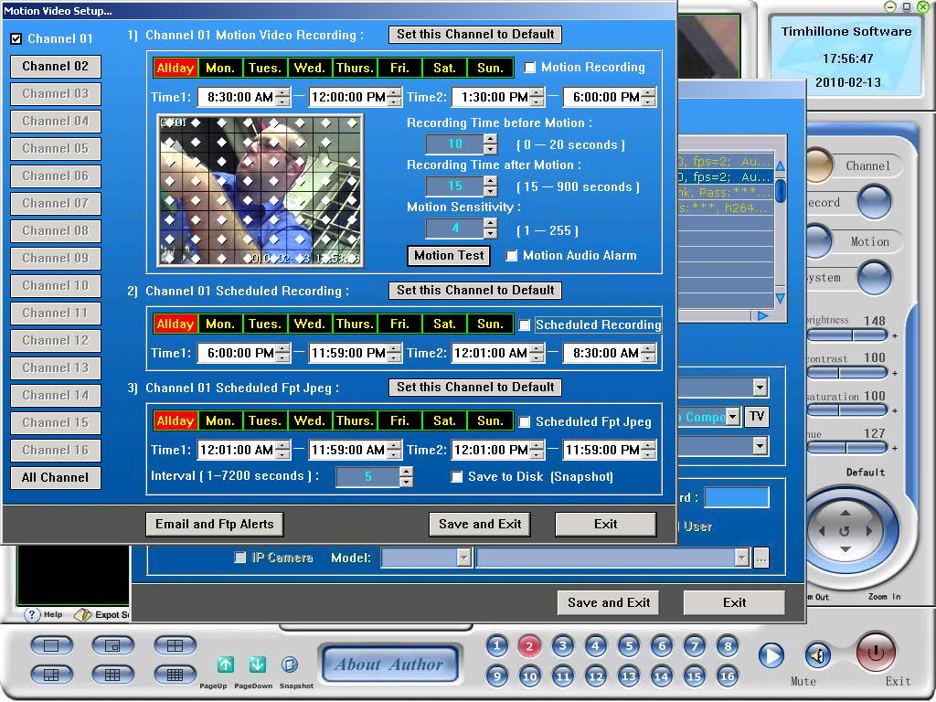

Here are some screen shots.... but it's not right to be forced to drop the cam res it is?
