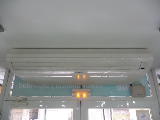

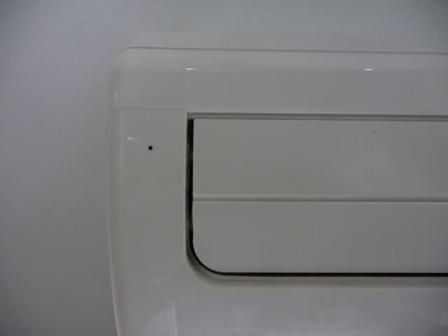

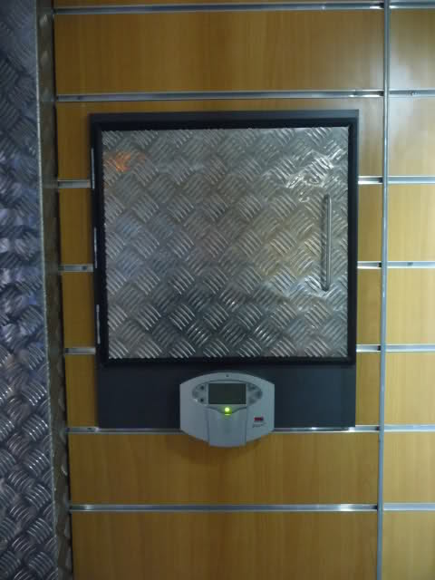

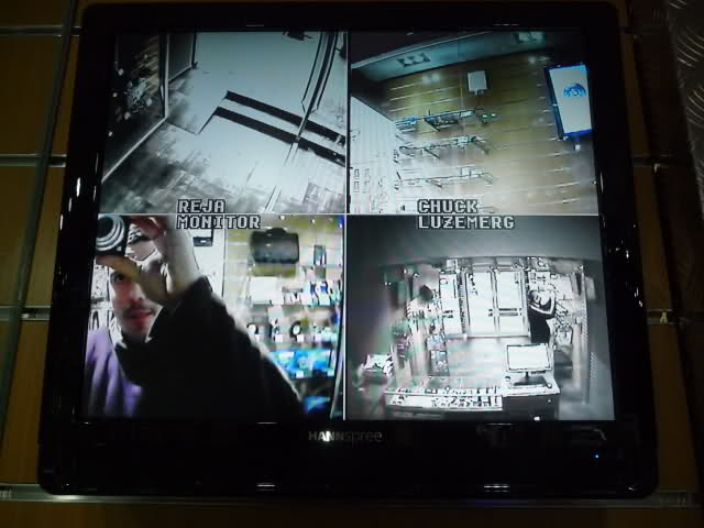

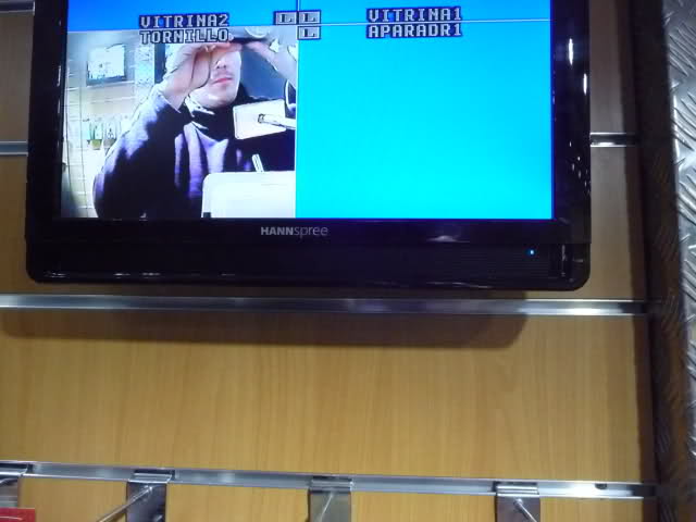

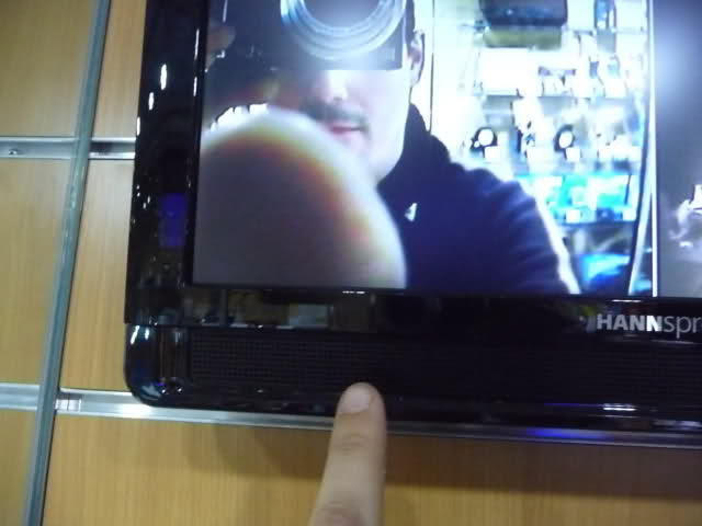

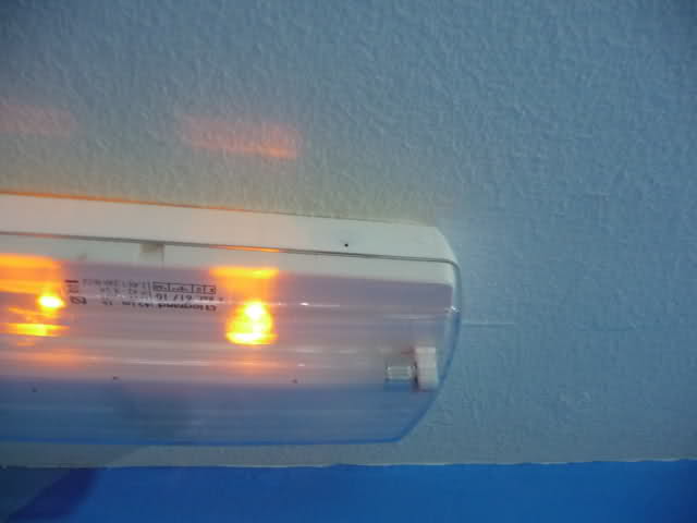

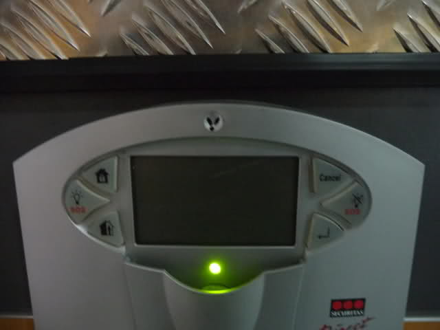

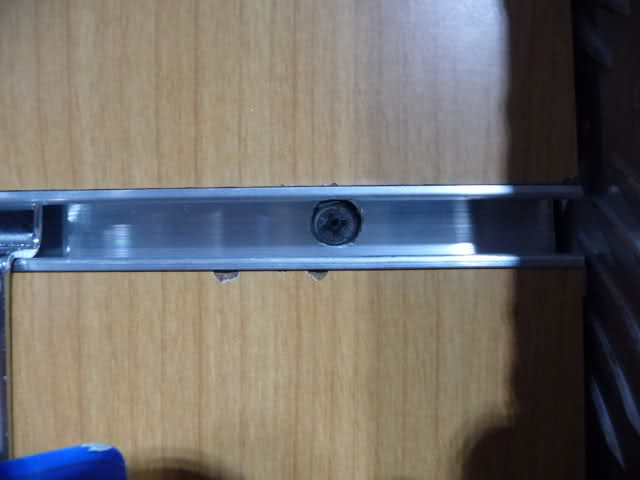

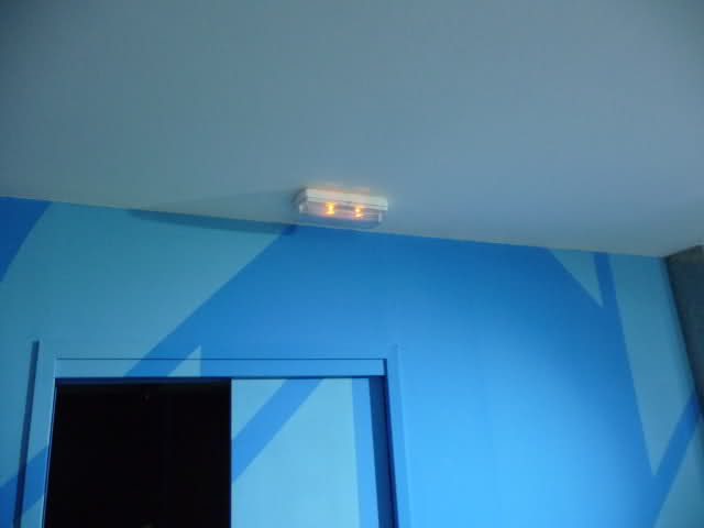

Securame 0 Posted March 8, 2010 Here are some pics, 5 custom hidden cameras! Cam1 - Hidden on monitor. We removed one of the speakers, and mounted the camera inside. It uses one of the existing holes on the monitor frame, so you can not notice anything from the outisde. Cam2 - Hidden on a screw. Not the pre-made screw, but one from the wall, so it is exactly the same as all the other ones. Cam3 - Hidden on the air conditioning unit. You can barely notice a very small hole if you look for it. Cam4 - Hidden on the alarm keypad. It is a non functional alarm keypad from an old alarm, it still has the 2 batteries from the old keypad to power the green led. Cam5 - Hidden on emergency exit light. The emergency light is functional. If you check the first picture (monitor), you will also see this camera in there, the one with name "LUZEMERG", you can see me in there taking the picture Share this post Link to post Share on other sites
scorpion 0 Posted March 8, 2010 Nice job! I quit buying the premade covert exit signs has they never would pass fire code. I prefer to use the original if time permits, or I buy the new LED style. It is fun trying to stuff a cameras in places. I love the " Wow, how did you install it in there"? Have you ever done fiber cameras? Share this post Link to post Share on other sites

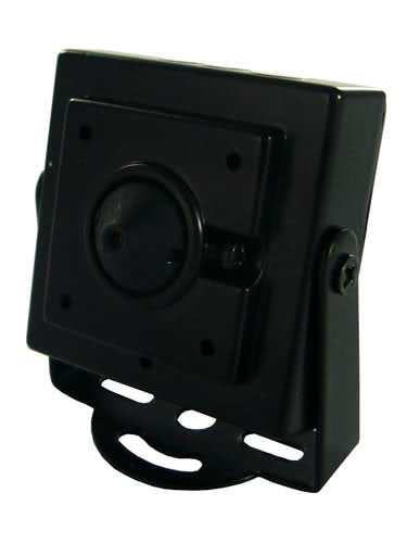

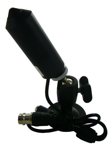

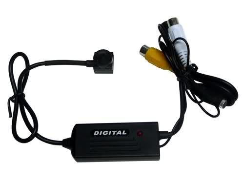

thewireguys 3 Posted March 8, 2010 Nice work Mindtwist!! " title="Applause" /> What cameras did you use? Share this post Link to post Share on other sites
Securame 0 Posted March 8, 2010 scorpion said: It is fun trying to stuff a cameras in places. I love the " Wow, how did you install it in there"?Have you ever done fiber cameras? Yeah, always better to insert the camera on something that really doesn't stand out on whatever place you are installing it, than to just use a pre-made hidden camera that woulnd't fool half of us around here hehe I have never used fiber cameras. thewireguys said: Nice work Mindtwist!! " title="Applause" /> What cameras did you use? We used this cameras. This one is Sony CCD 1/3 B&W 600TVL, low lux. It is the one on the air conditioning unit, and the alarm keypad. The microphone is unused. This is the one on the monitor and screw. I have several models, so I do not know for sure what sensor they have, but they are both colour cameras, I think 420tvl. And this is the one inside the emergency light. Also 420tvl, it does have colour, even on the picture seems to be B&W. It actually goes a little bit on the ceiling, so it would get some angle and point to the ground. Share this post Link to post Share on other sites
