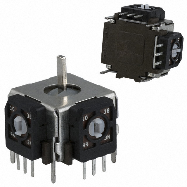

hardwired 0 Posted March 10, 2010 Can't say for sure why that is... But I "Fixed" a similar problem for the pilots at our local National Guard base who couldn't get used to moving the joystick up and down opposite of what they were used to in planes... If you can disassemble the keyboard and get to the actual joystick mechanism, odds are it has two potentiometers, one for up/down, and one for left/right, like this unsolder and reverse the two outside wires on the potentiometer for left/right, and it will reverse it's operation. Share this post Link to post Share on other sites

iank22 0 Posted March 11, 2010 i think the joystick is fine as im running another dome and i have no problems with that one. this pelco dome when moving the joystick move up and down ok and zooms in and out ok, its just when i move joystick left to right. The AD is listed as compatable for this dome Share this post Link to post Share on other sites
