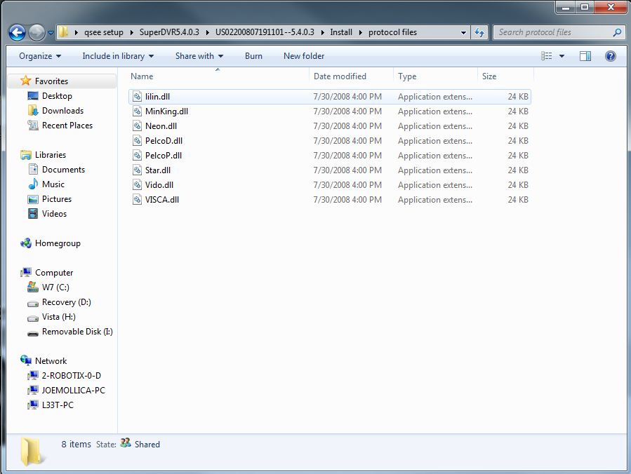

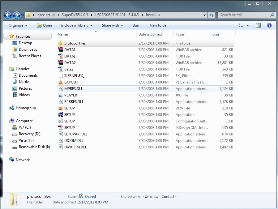

rory 0 Posted February 18, 2011 The driver is probably in one of the CAB files, see if you can Extract them? And people still wonder why I like to use XP Share this post Link to post Share on other sites
bmollica 0 Posted February 18, 2011 The driver is probably in one of the CAB files, see if you can Extract them?And people still wonder why I like to use XP with winrar "The archive is either in unknow format or damaged Share this post Link to post Share on other sites
rory 0 Posted February 18, 2011 The driver is probably in one of the CAB files, see if you can Extract them?And people still wonder why I like to use XP with winrar "The archive is either in unknow format or damaged LOL Ok another way to grab it is view hidden folders then goto the user's temp folder, and watch when you run the installer, dont continue with the install though, just let it extract it, then check the last folder created in the temp folder, should be it. You could also use extract from windows to extract the cab but its command line. Share this post Link to post Share on other sites
bmollica 0 Posted February 18, 2011 The driver is probably in one of the CAB files, see if you can Extract them?And people still wonder why I like to use XP with winrar "The archive is either in unknow format or damaged LOL Ok another way to grab it is view hidden folders then goto the user's temp folder, and watch when you run the installer, dont continue with the install though, just let it extract it, then check the last folder created in the temp folder, should be it. You could also use extract from windows to extract the cab but its command line. WOW! I never new that... cool trick lol. I ran the driver in compatibility for xp and as an admin. it installed.... when it finished i said to run the program the same way, but nothing happed. I just saw the process in the background but nothing came up. I chose compatibility for vista like i did before and got the same class does not exist. .erroorcode=0x583 error. oh well... at least i learned a few things thanks! Share this post Link to post Share on other sites

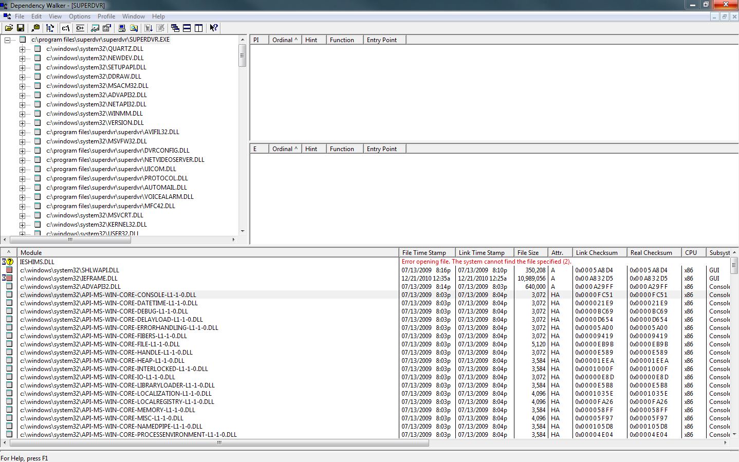

rory 0 Posted February 18, 2011 Maybe its Win7 home and Vista is Premium or something? The basic versions from at least Vista and on were missing alot of things that were even included in XP, but in the premium versions I think it contained those dependencies. The problem is finding out what is missing. You could use a good old program from MS called Depends, can take time though and still might be another issue, but basically go through every file the main EXE depends on, and make sure it is on the system - if not, will need to locate a version of it that would work in Win7, should be able to just copy it from Vista in most cases. When they made the installer for the "SuperDVR" they probably had XP in mind and relied on what is typically installed in XP by default - when Vista came along that messed us right up! So class does not exist could be looking for an external dependency file which contains the class, or the new updated dependency for Win7 is missing a class that was in either Vista or XP's version of the file. OR the program is just giving an error for some other reason, but if it works in Vista should work in Win7 as far as that goes. Also maybe just create a new Admin user and try it logged into that account? Share this post Link to post Share on other sites
bmollica 0 Posted February 18, 2011 Maybe its Win7 home and Vista is Premium or something?The basic versions from at least Vista and on were missing alot of things that were even included in XP, but in the premium versions I think it contained those dependencies. The problem is finding out what is missing. You could use a good old program from MS called Depends, can take time though and still might be another issue, but basically go through every file the main EXE depends on, and make sure it is on the system - if not, will need to locate a version of it that would work in Win7, should be able to just copy it from Vista in most cases. When they made the installer for the "SuperDVR" they probably had XP in mind and relied on what is typically installed in XP by default - when Vista came along that messed us right up! So class does not exist could be looking for an external dependency file which contains the class, or the new updated dependency for Win7 is missing a class that was in either Vista or XP's version of the file. OR the program is just giving an error for some other reason, but if it works in Vista should work in Win7 as far as that goes. Also maybe just create a new Admin user and try it logged into that account? I had vista home premium and now I am running 7 ultimate. Would vista premium have files that ultimate does not? Share this post Link to post Share on other sites
rory 0 Posted February 18, 2011 I had vista home premium and now I am running 7 ultimate. Would vista premium have files that ultimate does not? I cant say, but if you can winrar the main EXE (not the setup, the actual cctv exe) then upload it somewhere I can check the dependencies for you and all you would then need to do is a simple system search for the files to see if they exist. Tinyupload.com is one upload site that is simple to use. Share this post Link to post Share on other sites
bmollica 0 Posted February 19, 2011 I had vista home premium and now I am running 7 ultimate. Would vista premium have files that ultimate does not? I cant say, but if you can winrar the main EXE (not the setup, the actual cctv exe) then upload it somewhere I can check the dependencies for you and all you would then need to do is a simple system search for the files to see if they exist. Tinyupload.com is one upload site that is simple to use. http://brianmollica.info/dependency.JPG I ran that dependency walker on my w7 on the super dvr program and it says 2 files are missing... should I just copy these 2 over from vista into the same path? would there be other files that are not listed here? Share this post Link to post Share on other sites
rory 0 Posted February 19, 2011 Goto the Program Files, Internet explorer Folder, see if they are there. If so, the copy them to the Windows System32 folder and regsvr32 them both. If they arent in the IE folder, then copy them from Vista as long as both are 32 bit OS. Share this post Link to post Share on other sites
bmollica 0 Posted February 19, 2011 Goto the Program Files, Internet explorer Folder, see if they are there. If so, the copy them to the Windows System32 folder and regsvr32 them both. If they arent in the IE folder, then copy them from Vista as long as both are 32 bit OS. Both hlwapi.dll and ieframe.dll files ARE in c:\windows\system32. IESHMIS.DLL is not in c:\windows\system32\ but it is in C:\Program Files\Internet Explorer. Should I copy it to system 32? When I compaired it to my vista partition, that file does not even exist... What do you mean regsvr32 them both? Share this post Link to post Share on other sites

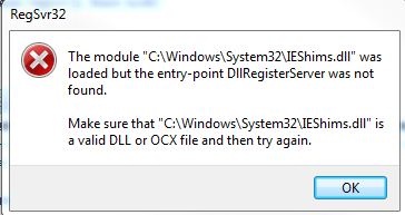

rory 0 Posted February 19, 2011 regsvr32 filename.dll or use the full path if you are not doing it within the system32 folder. So copy it to the system32 folder then enter this into the run box (or search on Win7) regsvr32 c:\windows\system32\IESHIMS.DLL this registers the DLL file on your system and then if the class exists in that DLL, it can now be found and no more error. Although I have none of those files on my XP installation. Share this post Link to post Share on other sites
bmollica 0 Posted February 20, 2011 regsvr32 filename.dll or use the full path if you are not doing it within the system32 folder. So copy it to the system32 folder then enter this into the run box (or search on Win7) regsvr32 c:\windows\system32\IESHIMS.DLL this registers the DLL file on your system and then if the class exists in that DLL, it can now be found and no more error. Although I have none of those files on my XP installation. I copied it and in the run box did regsvr32 C:\Windows\System32\IESHIMS.DLL and got this error Share this post Link to post Share on other sites
