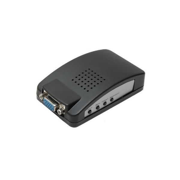

hi every one. how can i connect a normal pc monitor to my dvr. without vga as my monitor will be over 50m away form the dvr. can i use the bnc video out ( via shotgun) all the way to the moniter and use a vga to rca.see pic. thank you

You could just run normal BNC cable to the monitor, and there use a video to VGA adapter. The one in your picture won't do it, that is a VGA to AV cable, not the other way (they are not bidirectional).

hi people. thank for your reply. so can i not use a bnc lead but when the bnc comes to the monitor use a bnc to rca male converter to connect to the lead pictured in my first post,
No, you can't.
What you are showing on your first post is a VGA to video converter; you need a video to VGA converter.
