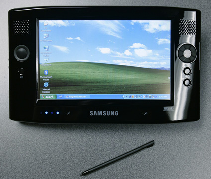

hardwired 0 Posted March 27, 2010 This is my setup tool, Samsung Q1 and the Nitek IPT148 ...Running XP and Explorer, so all the STUPID plugins work...Sorry was I shouting ? Manufacturers need to get away from those plugins........ Share this post Link to post Share on other sites
thewireguys 3 Posted March 27, 2010 hardwired said: This is my setup tool, Samsung Q1 and the Nitek IPT148 ...Running XP and Explorer, so all the STUPID plugins work...Sorry was I shouting ? Manufacturers need to get away from those plugins........ I want one so bad Share this post Link to post Share on other sites
Soundy 1 Posted March 27, 2010 ^^Saw a guy using one of those in a coffee shop the other day, that's a sick little toy! Although my new Asus netbook is pretty handy, too Share this post Link to post Share on other sites
thewireguys 3 Posted March 27, 2010 Soundy said: ^^Saw a guy using one of those in a coffee shop the other day, that's a sick little toy! Although my new Asus netbook is pretty handy, too Yea I have a friend that has one and they come in very hand for what we do.... They are all over ebay. Share this post Link to post Share on other sites
hardwired 0 Posted March 28, 2010 Got the Q1 used for $500, not too bad for what it does, still a little hard to see in the sun. Loads XP faster than a full size Sony laptop I have does with Vista (yeah, I know, that's not saying much) Still occasionally have to throw a jacket over my head like those photographers from the 1920's..... Share this post Link to post Share on other sites
Soundy 1 Posted March 28, 2010 That's one nice thing with my new ASUS netbook, the LED-backlit screen is insanely bright - it's even readable in direct sunlight. Share this post Link to post Share on other sites
