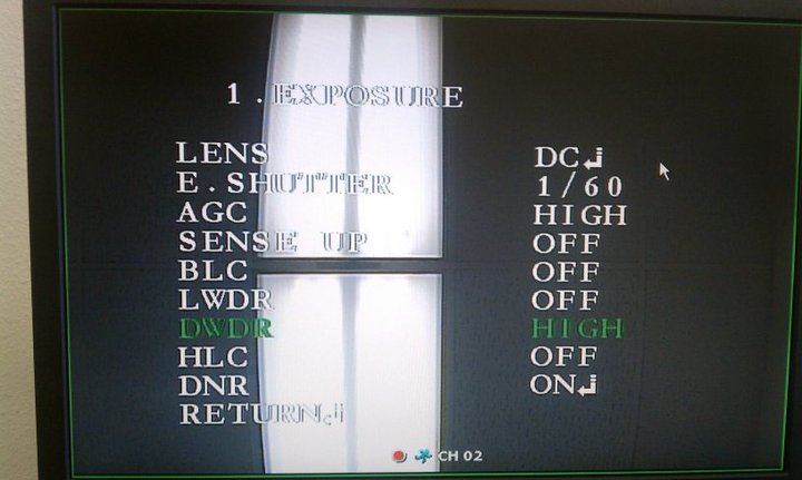

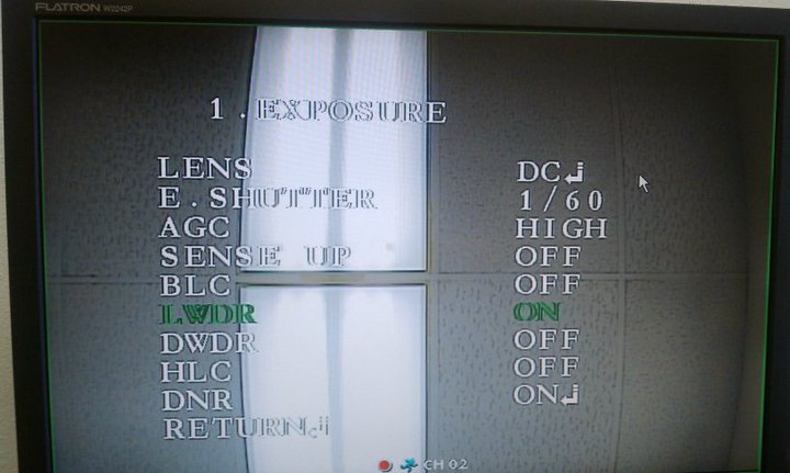

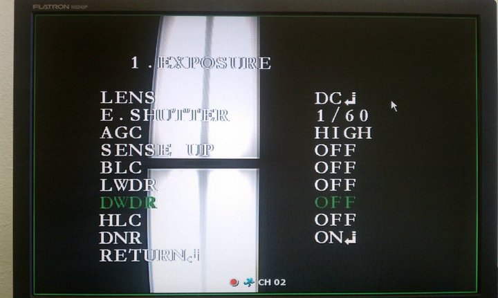

While I was testing Sony Effio and Huviron Gen2 DSP, I did a quick WDR test for you guys. Since Huviron Gen2 DSP support Both DWDR and WDR.
I took a few pictures with each on/off
Both WDR off
DWDR ON High
LWDR ON (True Mechnical/Low-Frame WDR)
You can clearly see the difference.

That is exactly what our LWDR do. With single scan CCD, it cuts one frame into half so first half the frame it takes one exposure in dark area and correct gamma value, and next half the frame it takes one exposure with bright area and correct gamma value, then the two exposures are combined in the nex frame. Basically this is why we call it LWDR (Low-Frame WDR) and obviously frame rate drops to 1/2 of the normal frame rate.
There's more advanced way but more expensive solution. We can use dual scan CCD like the one from Sony Effio so it take two long and short exposures at the same time basically saves 1/4 frame rate from single scan CCD WDR and total frame rate only drops to 3/4 of the normal frame rate. A bit smoother pictures. We call this SWDR.
DWDR, however, is manipulation of digitized picture in the camera. "It may make the output of camera looks better ( if it does work). but won't provide any extra detail." This is totally true, but there are more good things about DWDR so manufacturers can't totally ignore DWDR.
Most important thing is, DWDR does not drop any frame rate so pictures still look smooth and DWDR can be used with DIS function while real WDR can't use them at the same time.
