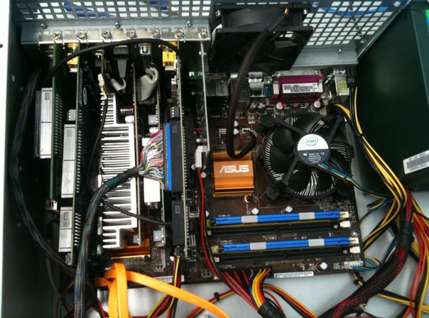

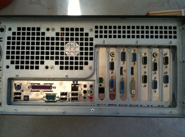

Heres a photo of our DVR... its really maxed out. We have 2 1120 cards, a gv-net card, a gv-loop card (hopefully it works we had issues once before with it but its all i have), 2 video cards, 4 channels of audio (we only need 4 channels although we know we can do more)
Wow... I've never seen that packed of a computer. Hopefully you wont have any heating issues... I'd make sure you keep the fan clean. It would be nice to have one of the large side fans on a system like that. Sounds like a nice install though... using RGB/HDMI/BNC... heck... you've got it all!
