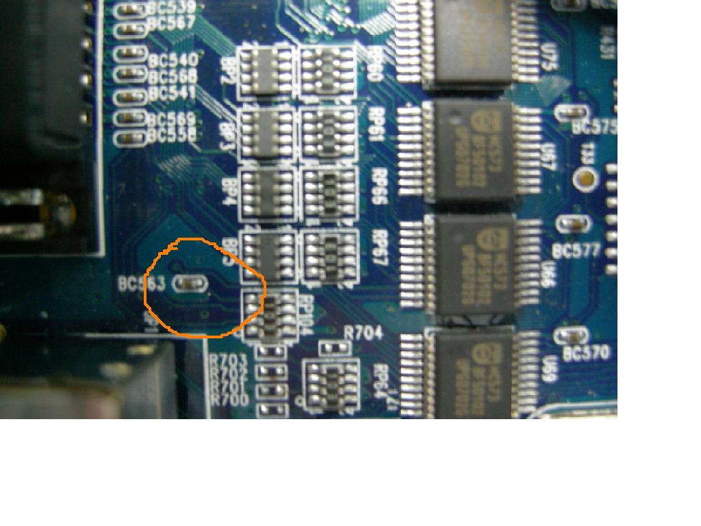

src 0 Posted April 15, 2010 I thought I would be smart and try and change the admin password/code from the default 0000 to nothing. Bad mistake, Now I cannot logon. I have searched the FAQ's and scorpiontheater.com site for reset info on the KPD674 but there is nothing out there. Anyone know the jumper on motherboard for this model so that I can perform a hardware reset ? TIA Share this post Link to post Share on other sites

cctv-man 0 Posted April 16, 2010 Find the attachment the hardware reset instructions of your DVR. It will reset your password back to “0000”. Please only do it if you are sure about this. STEP1:Remove the DVR cover and find the chip resistor to reset the hardware STPP2:The chip resistor is located on TP5/TP6, as indicated below: STEP3:Disconnect the DVR power. Then, make the chip resistor short-circuited with a conductive object (such as forceps) as indicated below, and re-connect the power. Remove the conductive object when you hear a short beep sound, and wait till the DVR reboots. Share this post Link to post Share on other sites
cctvlad 0 Posted April 16, 2010 this actually works I bought this DVR this week , I also thought id try to be smart and change password but it locked me out completely. was bricking myself (owner wanted to change channels i said i didnt know password) so i looked on here and lo and behold someone else had the exact same problem. did the hardware reset today and all is ok!! thanks very much fellas.!!! Share this post Link to post Share on other sites
src 0 Posted April 16, 2010 Wow thanks all, I emailed my supplier of my DVR earlier today and they helpfully provided the PDF on the Hardware Reset and a Firmware update for KPD674 before I seen all your replies. Did the Hardware reset successfully and above info from cctv-lad is exactly the instructions that I performed. Share this post Link to post Share on other sites

casacctv 0 Posted January 15, 2012 Having installed the firmware KPD674B_1013.zip for my KPD674B-C (Maplin code N08JU DVR), the DVR failed to boot with the error 'H.264 System Initial'. As a result, I followed the below referenced instructions and reset my firmware with the image from KPD674B_1014.zip. I'm now successfully operating firmware version 1014-1003-1008-1003. Thanks to CCTV-MAN for your assistance on this... Note: Although the pictures showing the location of TP5 and TP6 differed to my circuit layout, they were both just to the left of the SATA lead. --------------------------------------------------------------------------- STEP1:Remove the DVR cover and find the chip resistor to reset the hardware STPP2:The chip resistor is located on TP5/TP6, as indicated below: STEP3:Disconnect the DVR power. Then, make the chip resistor short-circuited with a conductive object (such as forceps) as indicated below, and re-connect the power. Remove the conductive object when you hear a short beep sound, and wait till the DVR reboots --------------------------------------------------------------------------- Share this post Link to post Share on other sites

flyby 0 Posted July 4, 2012 have anyone got a solutions on this problem ?My KPD674 do not boot up anymore? hi flyby. can you give more info ....... did your unit just stop working or have you tried doing a firmware and now have boot problems. first test with avtech is to remove hard drive and mouse then see if it reboots. Hi, I try to make a firmware upgrade true the webpanel. It looked so eazy.. I´v remove the HD, mouse, and everything else, but It stille only say "system initial" thanks will this work ? STEP1:Remove the DVR cover and find the chip resistor to reset the hardware STPP2:The chip resistor is located on TP5/TP6, as indicated below: STEP3:Disconnect the DVR power. Then, make the chip resistor short-circuited with a conductive object (such as forceps) as indicated below, and re-connect the power. Remove the conductive object when you hear a short beep sound, and wait till the DVR reboots. Share this post Link to post Share on other sites
tomcctv 190 Posted July 4, 2012 yes you can give it a go. but still not 100% fix it depends on the firmware you tried to load. the wrong region could wipe your units software. Share this post Link to post Share on other sites
flyby 0 Posted July 4, 2012 (edited) yes you can give it a go. but still not 100% fix it depends on the firmware you tried to load. the wrong region could wipe your units software. I used Firmware v.1017 My circuit board do not look like this. Edited July 4, 2012 by Guest Share this post Link to post Share on other sites
tomcctv 190 Posted July 4, 2012 hi. then you dont have the 674B ..... can you post a picture of your board Share this post Link to post Share on other sites
flyby 0 Posted July 4, 2012 hi. then you dont have the 674B ..... can you post a picture of your board I used Firmware v.1017 My circuit board do not look like this. Share this post Link to post Share on other sites
flyby 0 Posted July 7, 2012 hi. then you dont have the 674B ..... can you post a picture of your board I used Firmware v.1017 My circuit board do not look like this. Any help Share this post Link to post Share on other sites

dayatxp3 0 Posted October 3, 2013 Find the attachment the hardware reset instructions of your DVR. It will reset your password back to “0000”. Please only do it if you are sure about this. STEP1:Remove the DVR cover and find the chip resistor to reset the hardware STPP2:The chip resistor is located on TP5/TP6, as indicated below: STEP3:Disconnect the DVR power. Then, make the chip resistor short-circuited with a conductive object (such as forceps) as indicated below, and re-connect the power. Remove the conductive object when you hear a short beep sound, and wait till the DVR reboots. [attachment=0]KPD674_Hardware_Reset.jpg[/attachment] thankyou master... you is the best.. thankyou verry much.. Share this post Link to post Share on other sites

Rajesh Singh 0 Posted July 22, 2014 Having installed the firmware KPD674B_1013.zip for my KPD674B-C (Maplin code N08JU DVR), the DVR failed to boot with the error 'H.264 System Initial'. As a result, I followed the below referenced instructions and reset my firmware with the image from KPD674B_1014.zip. I'm now successfully operating firmware version 1014-1003-1008-1003. Thanks to CCTV-MAN for your assistance on this... Note: Although the pictures showing the location of TP5 and TP6 differed to my circuit layout, they were both just to the left of the SATA lead. --------------------------------------------------------------------------- STEP1:Remove the DVR cover and find the chip resistor to reset the hardware STPP2:The chip resistor is located on TP5/TP6, as indicated below: STEP3:Disconnect the DVR power. Then, make the chip resistor short-circuited with a conductive object (such as forceps) as indicated below, and re-connect the power. Remove the conductive object when you hear a short beep sound, and wait till the DVR reboots --------------------------------------------------------------------------- Share this post Link to post Share on other sites
cesarhl 0 Posted December 1, 2014 I tried the reset procedure, I unplugged the unit make the contact TP6 and TP5 plunged it back in and the machine said "initialize set up" and then i get to the keypad enter "0000" and says "warning password error" what am i doing wrong? DVR Share this post Link to post Share on other sites
rkilpa 0 Posted May 1, 2015 This worked to reset my KPD675H DVR, too. I am donating my old system to Goodwill and I removed all User names including what was originally setup as admin. No user names locks up the system when you try to access the menus. This reset procedure sets up the DVR like day one. Clears all users and camera titles. I was able to wipe the hard drive so someone will be getting a like new system. Thanks for your great instructions. Share this post Link to post Share on other sites
Gomp5 0 Posted September 9, 2016 Will the factory reset for the KPD674 work for the KPD675C-C ? I have found the Tp5 and tp6 points. right next to the sata port. Share this post Link to post Share on other sites
