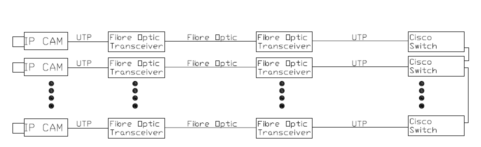

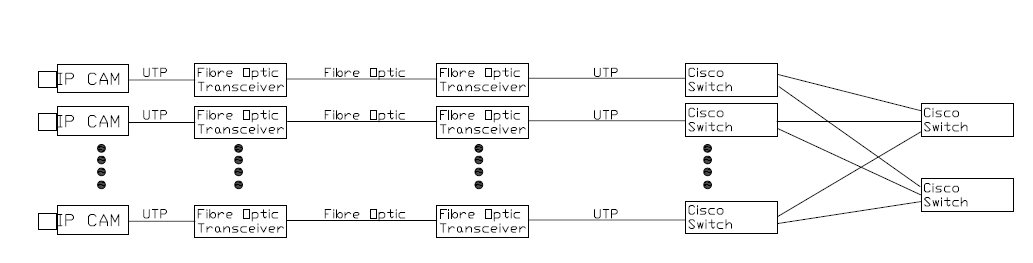

chun 0 Posted April 21, 2010 Need help on the following case, Thanks: For Design 1 What is the Cisco router that will be recommended? For Design 2 What is the Cisco router that will be recommended? Both amount of IP Cameras is 300. The switches all location in the same room. Share this post Link to post Share on other sites
zmxtech 0 Posted April 24, 2010 cisco 3750 PS for the switches [POE] and/or and cisco 4500 switch with a router blade you will need 2 subnets and run GB uplinks design 2 does not make any sense ? you have switches into switches ? z Share this post Link to post Share on other sites
chun 0 Posted April 25, 2010 cisco 3750 PS for the switches [POE]and/or and cisco 4500 switch with a router blade you will need 2 subnets and run GB uplinks design 2 does not make any sense ? you have switches into switches ? z thanks design 2 is to provide redundancy Share this post Link to post Share on other sites
