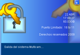

gamba47 0 Posted April 22, 2010 (edited) Hi guys i´m with a strange problem. We are updating a server with 11 cameras and adding 3 cameras more. When we open GV-800 system software we see this message (in spanish): "Puerto Limitado 16 to 11 " Puerto limitado is equal to limited port. Did you know what this mean ? I try to get an screenshot but with not success. best regards. Edit - addin screenshot Edited April 23, 2010 by Guest Share this post Link to post Share on other sites

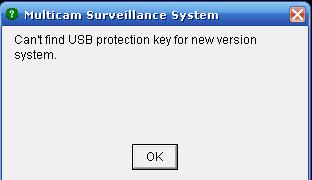

gamba47 0 Posted April 22, 2010 changing to GV 7.05 i get the same: addin this: Help! Share this post Link to post Share on other sites
gamba47 0 Posted April 23, 2010 Both problems solved. First problem: Limit port 16 to 11 This is for Geovision V6.x wich don´t have the option to disable de beep from video lost. In this version we can disable cameras. I enable all and i get no limit port. Second problem: "can´t find usb key...." The card is a clone and can´t run versions upper than 7. I have to install 6.05 version to get it work. Best regards. gamba47 Share this post Link to post Share on other sites
