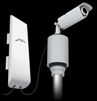

thewireguys 3 Posted June 17, 2010 buellwinkle said: As for wireless, of course hardwire as much as you can, but if you need wireless, the least expensive is Ubiquiti Nanostations. Made for cameras, comes with pole mount and power injector. Also has PoE out to power the camera. They cost about $89 each in the US. They also come in 2.4 and 5.8 Ghz. As for a computer to manage this all, this will be tough, lots of cameras. Did they include a price on a proper PoE network switch? Exacq softwware can be expensive per camera. You may be better off buying better cameras, using less expensive software like BlueIrisSoftware.com, Castlekeeper.40th.com, h264soft.com, all of which will be way, way less expensive. Most if not all of the software packages, even Milstone The Nanostation is not IEEE 802.3af you will not beak to pier the cameras with POE. I would stay away from Vivotek.... Axis does now have a cheaper line of cameras out and Acti has some nice stuff. Share this post Link to post Share on other sites
buellwinkle 0 Posted June 18, 2010 Sorry, it's the Ubiquiti Nanostation M that has PoE (802.3af,) output to power the camera. They have different models and the Nanostation 2 or 5 do not have PoE output for the camera. Here's an image from their website Share this post Link to post Share on other sites
thewireguys 3 Posted June 18, 2010 buellwinkle said: Sorry, it's the Ubiquiti Nanostation M that has PoE (802.3af,) output to power the camera. They have different models and the Nanostation 2 or 5 do not have PoE output for the camera. Here's an image from their website I spoke with there tech support and they told me there products are not 802.3af. They have a adapter that does but it is miss leading, it takes the 802.3af and converts it to Ubiquiti's standard. I have not tested this for myself, but I did call and speak with there support. I do hope that he was incorrect Share this post Link to post Share on other sites
hardwired 0 Posted June 18, 2010 thewireguys said: buellwinkle said: Sorry, it's the Ubiquiti Nanostation M that has PoE (802.3af,) output to power the camera. They have different models and the Nanostation 2 or 5 do not have PoE output for the camera. Here's an image from their website I spoke with there tech support and they told me there products are not 802.3af. They have a adapter that does but it is miss leading, it takes the 802.3af and converts it to Ubiquiti's standard. I have not tested this for myself, but I did call and speak with there support. I do hope that he was incorrect He was not incorrect, although I have found a way to power some cameras on the same line as the Nanostation radios. They will not power up from the PoE directly (I tested this with cams from Panasonic, Acti, and Mobotix), but by using a passive power injector block, you can peel the power off of the CAT5 cable, and then go to the camera's standard power input port. Ubiquiti makes power injectors in 15, 18, and 24 volt, I used the 24 volt model for testing this, to allow as much cable losses as possible. I do agree, that picture is a little misleading, I had a few conversations with Ubiquiti about that. The Nanostation "M" models are working extremely well for me, and the 2.4 Ghz model will cut through a surprising amount of trees/foliage, compared to other wireless gear. Share this post Link to post Share on other sites
