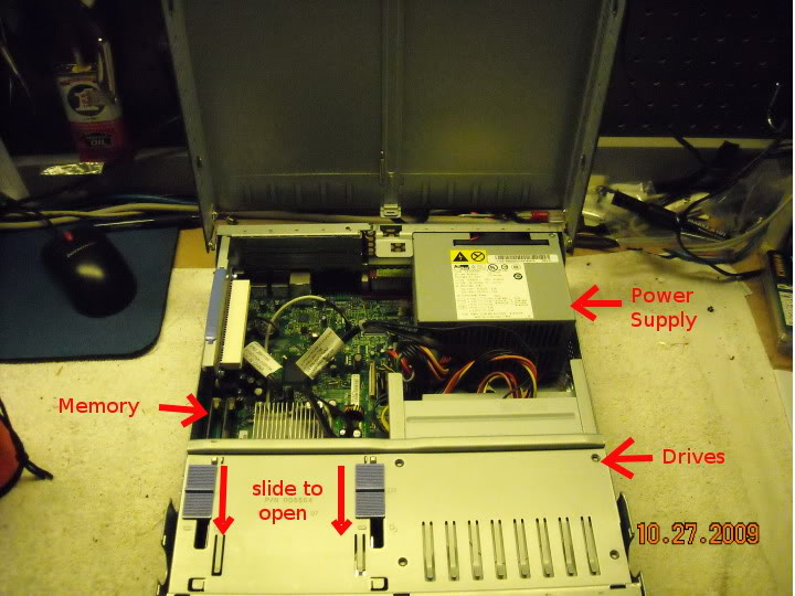

I've used off-lease corporate small-form-factor desktops to build several NVRs (you can get them cheap as dirt on Ebay)... and other than adding a big fat drive and a real network card (Intel Pro/1000), they're good-to-go. The dual-core processor will run 8-10 cameras in Luxriot with little problem.
Here's a favorite: a Lenovo M55 Thinkcentre

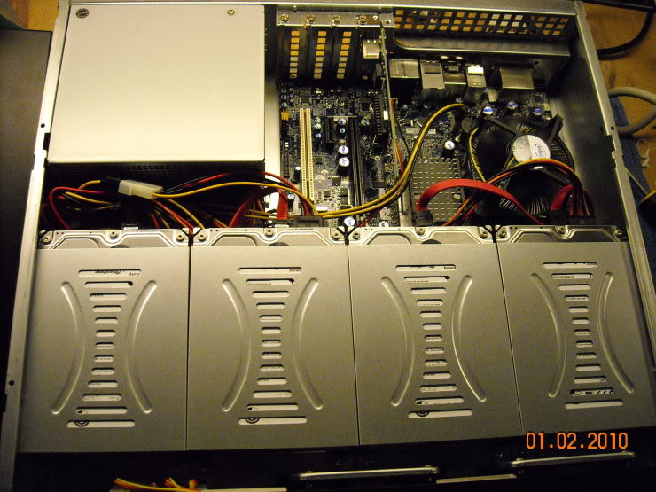

For bigger installs and megapixel-heavy setups, you need something different. Here's one I built in a 2U case, with a quad-core and four 1.5TB drives:
