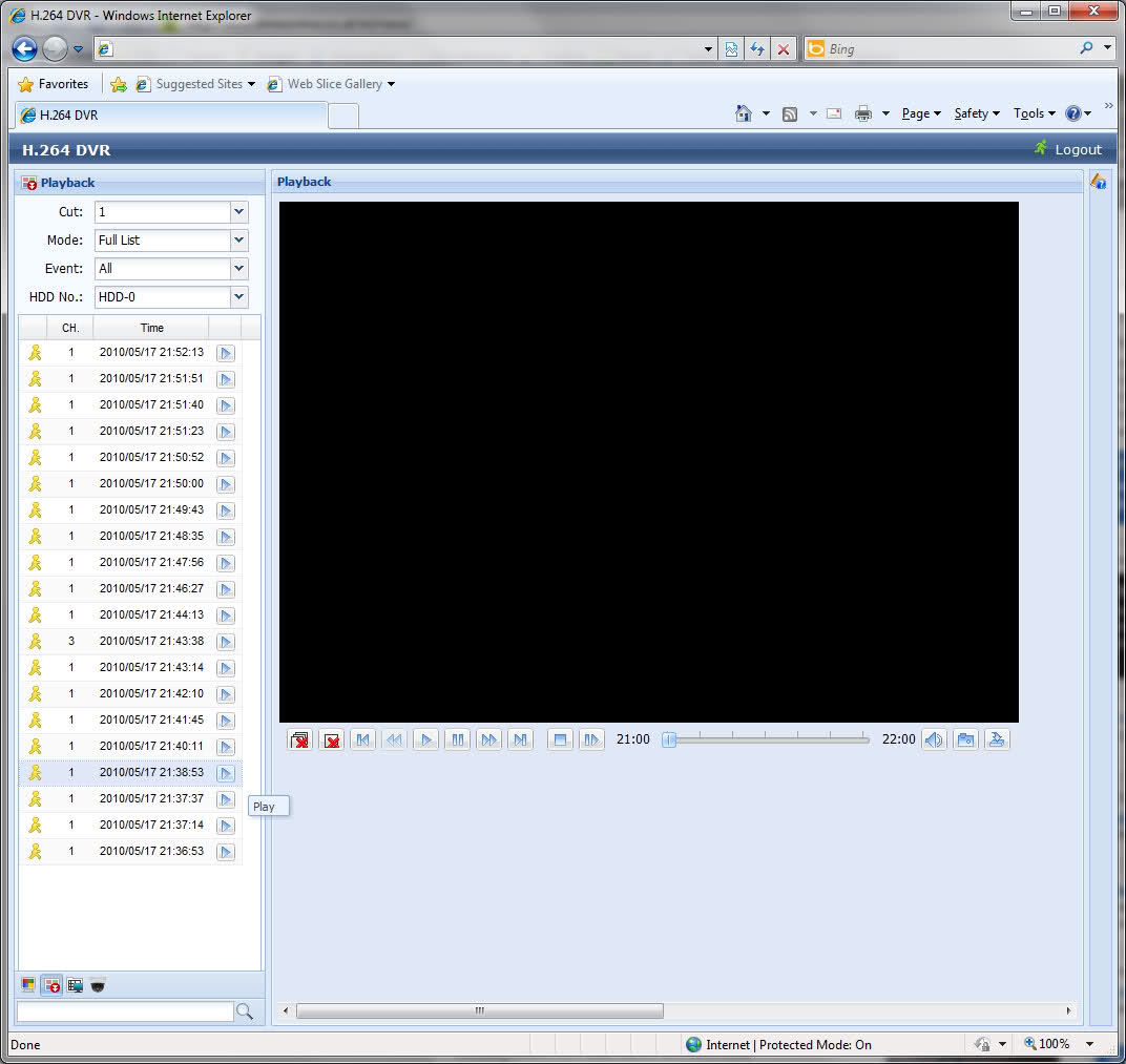

scorpion 0 Posted May 17, 2010 Quote Edit: Still cannot get remote playback via IE8. Not sure what's up. What does this mean? You may have to right click the icon and use as administrator. Is this the issue? Are you getting an error code such as this? 0xc0000022 ? This would mean you need to be administrator. Share this post Link to post Share on other sites
geezaa 0 Posted May 17, 2010 (edited) scorpion said: Quote Edit: Still cannot get remote playback via IE8. Not sure what's up. What does this mean? You may have to right click the icon and use as administrator. Is this the issue? Are you getting an error code such as this? 0xc0000022 ? This would mean you need to be administrator. Scorpion, you are a genius! Sorry for the vagueness. What I meant was, when I tried to replay recorded video via Internet Explorer 8, I couldn't get any playback. The screen would just stay blank, no error messages. Like this: Live view was working fine, only playback didn't work. However, I just tried running IE8 in administrator mode and...playback now also works! So..I can now view live, playback recordings, and download recordings: -directly on the DVR -across my local area network at home through either 1. Video Viewer Software or 2. Internet Explorer 8 -worldwide across the internet through IE8 Yep, I'm a happy bunny! Edited May 17, 2010 by Guest Share this post Link to post Share on other sites

scorpion 0 Posted May 18, 2010 If your computer is setup with other user accounts then right click the Explorer icon. You will see another Explorer icon. Right Click that one and click Run as Administrator. This way you do not have to switch to the Admin account Share this post Link to post Share on other sites

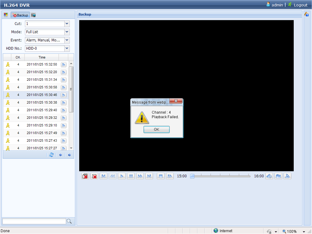

Petros 0 Posted January 25, 2011 Hello, First of all I would like to thanks for this wonderful forum! I have found it today while I was using google, trying to find a solution for my problem… I have a KPD-674(ZL), everything was working fine, until i have decided to format my computers. I have 3 pc’s with win XP, The problem is with web interface, I cannot using the playback, the screen staying black, and im getting the message “channel x : playback failed” Im using ie .8 on 2 pc’s and ie 6 on the third. The strange thing is that the playback is working on the 2 pc’s (ie .8 & ie 6) but not on the third pc (ie 8 ) That is very strange because the two pc’s have the same operating system (winxp sp3 ie 8 ) how is possible to work in the first and not in the other ? I have updated the dvr firmware today with KPD674_1042.rar (thanks roula for this) but still I have the same problem. I have tried everything, (running ie 8 in administrator mode, updating the coders, install vlc, but still can’t make it working) Also did somebody can tell me what it means the ZL after my dvr KPD674 model?, Can i use the firmware updates for the A models? The original firmware version was : 1039D-1014D-1017D-1016D now is : 1042-1014-1018-1017, what was the D, that it’s “gone” ? Also before one week I have noticed that the playback wasn’t works on ie 9 in windows 7 any solution for this ? (preview mode is ok) untill now and after the update the dvr is working well, from the video viewer I can playback saved files. But not on ie. Thanks in advance and sorry for my big post. Share this post Link to post Share on other sites
AllenG 0 Posted June 13, 2011 I have had the same problem. IE8 on Windows 7 pro 64 bit. If you have Avast Virus checker try disabling the "Web shield". Playback of events works for me in IE8 now. I have posted on another thread on this forum asking how to put in an exclusion for Avast so that I can re-enable the web shield. no reply yet. http://www.cctvforum.com/viewtopic.php?f=56&t=25600&p=157472&e=157472 I hope this helps. Regards Allen. Share this post Link to post Share on other sites
Petros 0 Posted June 30, 2011 Hello Allen, You're right, that was the problem.. I founded when i was make format on my laptop, but i forgot to post it after. Thanks anyway in advance. Everything is ok now! Share this post Link to post Share on other sites
