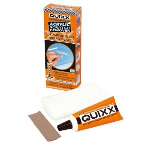

Quixx Acrylic Scratch Remover
"The same engineering that made QUIXX High Performance Paint Scratch Remover so successful has now been applied to acrylic and Plexiglas. QUIXX High Performance Acrylic Scratch Remover quickly and easily removes scratches from acrylic and Plexiglas surfaces including headlamps, rear lamps, dashboard, wood trim with clear coat, motorcycle windshields, RV windows, boat windows, aircraft windows, and even acrylic glass bath tubs and furniture. QUIXX High Performance Acrylic Scratch Remover restores surfaces to a scratch-free finish. The kit includes 1 tube (50G/1.76oz) of QUIXX Acrylic Scratch Remover, 1 polishing cloth, and 2 strips of special abrasive paper (1600 grit). "
