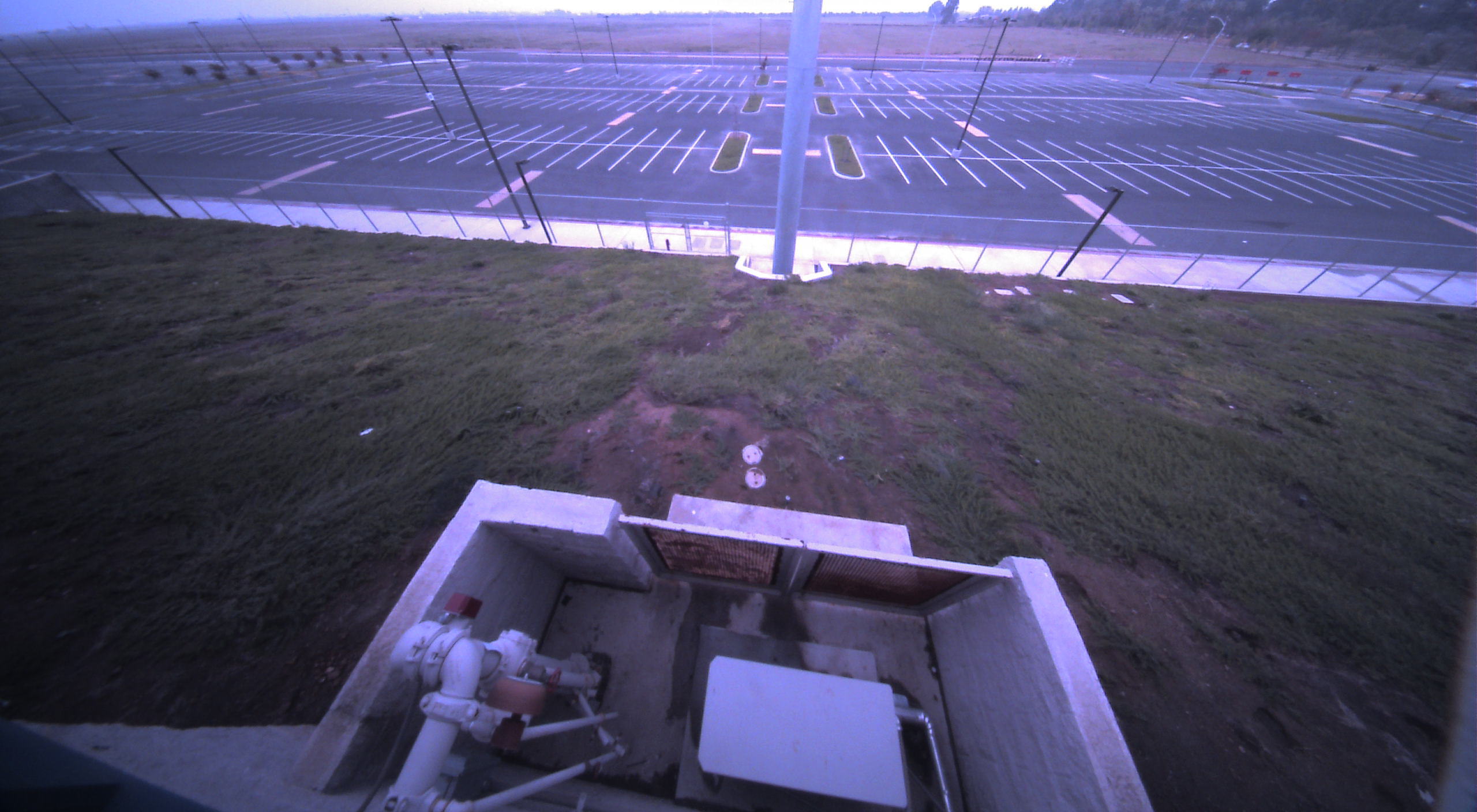

hardwired 0 Posted May 25, 2010 Theia lenses do work very well, however, you'll have a heck of a time finding a housing for them that you will not see the edges/sun-shield in the view. I ended up using an EMI flat front housing (claimed weatherproof, but no gasket or sealed edges!), and sealed the heck out of it with silicone. You will probably want to digitally crop part of the top/bottom of the image, otherwise you usually get a lot of sky and foreground. Here's a sample from an Arecont 5MP/ Theia SY125 lens. **********Edit********* Kowa also makes a nice 3.5MM fixed, as well as a 3.5-10MM varifocal. I have used the fixed lens, it has a really nice image. Haven't tried the varifocal, though. Share this post Link to post Share on other sites

rory 0 Posted May 25, 2010 Here's a sample from an Arecont 5MP/ Theia SY125 lens. awesome " title="Applause" /> Share this post Link to post Share on other sites
thewireguys 3 Posted May 25, 2010 Theia lenses do work very well, however, you'll have a heck of a time finding a housing for them that you will not see the edges/sun-shield in the view. I ended up using an EMI flat front housing (claimed weatherproof, but no gasket or sealed edges!), and sealed the heck out of it with silicone. You will probably want to digitally crop part of the top/bottom of the image, otherwise you usually get a lot of sky and foreground. Here's a sample from an Arecont 5MP/ Theia SY125 lens. **********Edit********* Kowa also makes a nice 3.5MM fixed, as well as a 3.5-10MM varifocal. I have used the fixed lens, it has a really nice image. Haven't tried the varifocal, though. Theia has some recommend housings on there website that work with the lens Share this post Link to post Share on other sites
hardwired 0 Posted May 25, 2010 Theia has some recommend housings on there website that work with the lens I looked at their suggestions, but I can assure you, anything with a sun shield is going to REALLY cut into the view. A dome might be the best bet. Share this post Link to post Share on other sites
