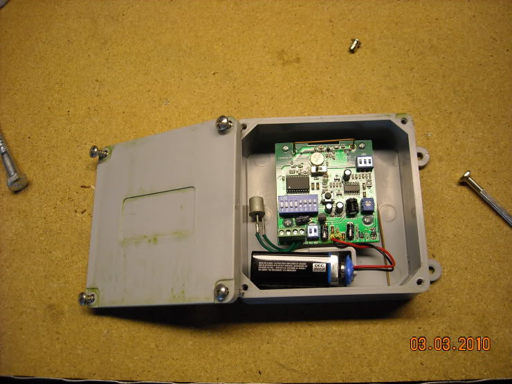

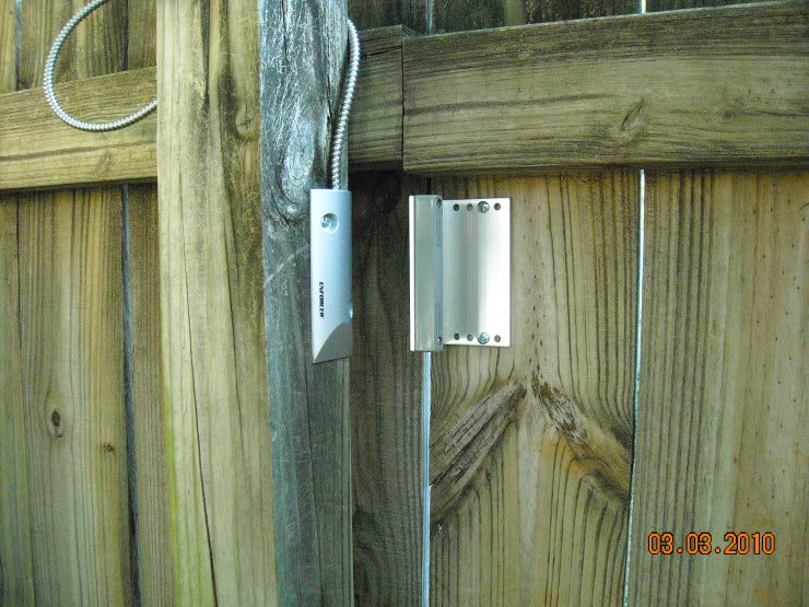

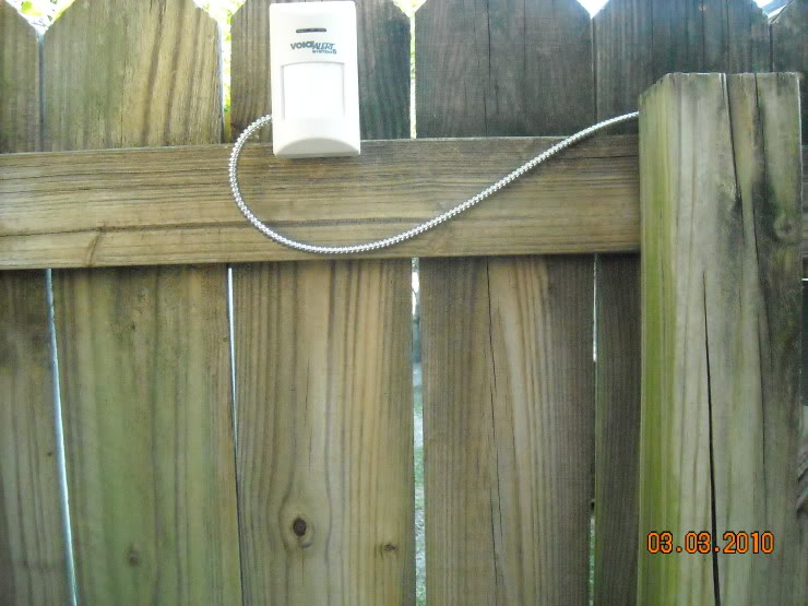

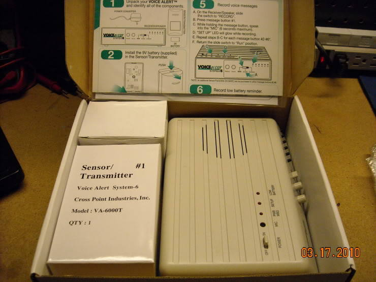

Sawbones 0 Posted May 21, 2010 cglaeser speaks the truth on this one. Cameras systems are good. Believe me... I'm a big fan... but quality night images are very tough to come by with limited expertise, and consumer-grade hardware. Unless you get lucky, you're not going to see very much... and you have to carefully select cameras based on available lighting, and so forth. Catching somebody moving around at night is what separates the men from the boys in the camera world. The wireless alarm idea has real merit; I'm using it myself. Even though I have a serious alarm on my home, it only covers the building perimeter (windows, doors, etc), so I still use separate sensors outside the house to catch anybody screwing around. More specifically, this system: http://www.voicealert.com/ Their PIRs are not the greatest... but they have motion sensors, driveway sensors, and you can hack their transmitters into serving as remote alarm sensors for other applications: Here is a gate I alarmed: They even have motion sensors you can place on an object (or inside the pocket of a car door): Lots of options... be creative! And catch the bastards. Share this post Link to post Share on other sites

rory 0 Posted May 21, 2010 Motion lighting as mentioned. I wouldnt use outdoor motion sensors for the alarm though, too much chance of false alarms (monitoring companies will cut you off quick), go beams if anything, check optex for those. Well you could use outdoor motions, but just be forwarned, they tend to false alot more then beams do, also depends on where they are installed. And Voice Alert which sawbones posted, looks like a good alternative to tying it into your main alarm. Share this post Link to post Share on other sites

cglaeser 0 Posted May 21, 2010 Motion lighting as mentioned. I wouldnt use outdoor motion sensors for the alarm though, too much chance of false alarms (monitoring companies will cut you off quick), go beams if anything, check optex for those. Right, I wouldn't add the outdoor motion sensors to the monitored home alarm. I have two alarm systems, one that is monitored for the house, and one for all the outdoor sensors (motion, side gates, and mail box). The alarm for the outdoors has voice commands, and lets me know which zone is faulted at 2 am so I can get up and check the video monitor. Well you could use outdoor motions, but just be forwarned, they tend to false alot more then beams do, also depends on where they are installed. The Optex PIRs are excellent. The Crow DareDevils are reportedly very good too. And Voice Alert which sawbones posted, looks like a good alternative to tying it into your main alarm. I used a Honeywell LYNXR for the second alarm. Best, Christopher Share this post Link to post Share on other sites
