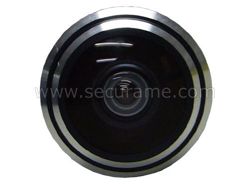

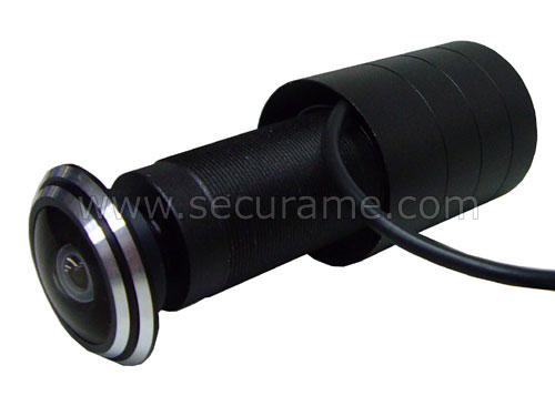

The kt&c looks just like that. Any suggestions on how to install it in the wall? I am trying to avoid cutting the wall up. The back end of the camera is larger then the front. I found a metal circle piece that I can place over the lens to cover the additional room from the hole. I was thinking about drilling a hole the size of the wider back portion of the camera. I am not sure how to mount it in the wall. I haven't done this yet so any suggestions would be great. I would prefer to have this installed in the wall so the lens is flush.
that big back piece u can throw in the trash, its not necessary. the actual camera is about the size of a lipstick thing. the lens "peephole" mounts flush with whatever you install it in. just drill a 3/4" hole if memory serves me right...
I didnt realize the back piece wasnt needed. I will have to take a closer look tomorrow and see if I can remove it.
