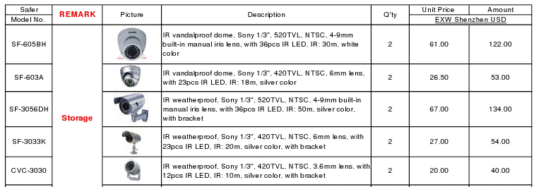

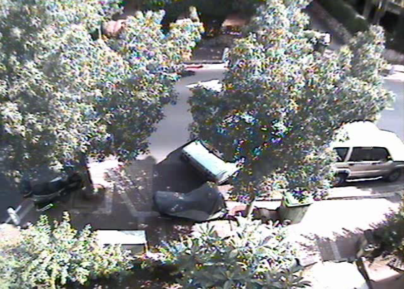

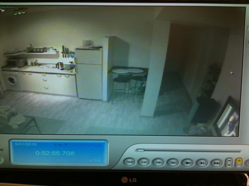

omer78 0 Posted June 3, 2010 Hey guys, i need some help with my camera, ok so i bought 10x cameras to work with my GV-800 card. here are the models: my problem is that after i mounted the SF-3033k 3.6mm camera outside my window to view my motorcycle the picture that im getting on my PC and on my recordings are awful 24 hours, yesterday the lady with the Subaru hit my bike when trying to park her car, i was in shock seeing this on my records but im unable to catch the license plate due to the bad quality of the movies. The dome cameras i mounted inside the house is also pretty bad cause it seams that the living room camera IR feature always working, only when the lights are 100% ON i can see that the IR is off, which gives me the following image: CAMERA: CVC-3030 3.6mm All cameras was purchased from this website: [mod edit store removed] Please help me, to understand why the quality is so bad and if it is because the camera, what camera do you think can do a god job with my GV-800 in order to view a clear image of my bike and a plate number in case it happens again. Any help will be highly appreciated. Share this post Link to post Share on other sites
Soundy 1 Posted June 3, 2010 Well, let's start with the obvious: these are all cheap junk cameras and the pictures you're getting out of them are pretty much what one would expect from them. As far as capturing plates, you're going to have a very hard time from that angle regardless of what camera you use - you'll be looking at the top edge of the plate. You could do it with a better analog camera, but you'll need something with a lot tighter view around the bike, and you'd have to mount it a lot lower, not just to get the angle on the plates, but to clear all the foliage. Really though, how often does your bike get backed into? Statistically speaking, what are the odds of it getting hit again anytime soon? I'm just saying... Share this post Link to post Share on other sites

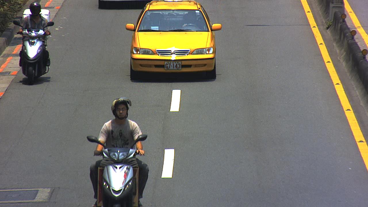

omer78 0 Posted June 3, 2010 Dear friend, thx for the quick replay, i didn't realized that my camera was so bad, i saw some demos for ACTI, vivotek cameras and the images are so clear compering to what i get. my dvr card is analog so i have to stick with analog cameras, is there any good model you think might do the job for me? i cant move my camera position due to the fact it is outside my living room window looking directly at my bike but maybe i should buy a camera with manual zoom so i can get a closer image. a few month ago some one stole a part from my bike and i found it only the day after when i went to work and so the missing part. a lot of cars park over there so it can happen again. i must get a better camera and i hope there are analog cameras that would bring a clear image with my current configuration, something like this image, look how you see the plate so clearly and everything alse as well: i don't mind buying one good camera to watch my bike, at home, well i will live with what i already have. any good IR day night analog camera that can work for me, as you can see my bike is approx 40ft from the cam. thx again!! Share this post Link to post Share on other sites
Soundy 1 Posted June 3, 2010 That photo is not from an analog CCTV camera. Look at the dimensions: 1280x720 - that's a megapixel camera (well, technically just under one megapixel, but still...), essentially 720p HDTV resolution. It's also using a larger sensor and a better-quality lens than your cameras (a basic megapixel lens is probably worth more than one of your cameras). These type of cameras don't use your capture card; they plug into the network and your DVR records the data from there. You need either specific software for the camera, or I believe newer versions of the GeoVision software will support some network cameras. Many of these cameras can also record to internal memory (SD card). You could put a longer lens on the camera to get a tighter shot of the bike (probably need something in a 12mm) but you'll still be limited by the capabilities of the camera and the DVR itself. Regardless of the camera or lens, you still won't be able to read most plates from that angle. Share this post Link to post Share on other sites
