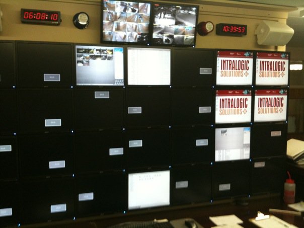

Adam Daley 0 Posted June 11, 2010 So I have a client whos got 30 monitors going up. I might have mentioned this a while ago but its happening. Now... we're monitoring i'd say 20+ off-site locations. We're using Center V2 to do this so that they are not streaming every camera 24/7, only if motion is detected does it pop-up... the issue we're having is we don't like the 6 camera display in center v2, not enough cameras sometimes (most systems have a dozen cameras)... we can do 15 but the cameras are small... what we'd really like to do is the 9 camera view, but thats only an option if you FLOAT the log... welll our issue is 1) Each system has a single display running Center V2 2) We prefer to run at 1024x768 as it keeps things clean/big 3) Switching to 1280x1024 i think gave us the FLOATING option, but agian we'd have to hide it and what not and it wasnt realy a great way to do it So is there a way/hack to get the log to STOP showing up on the bottom, we don't care to see it at all (we actually have a dedicated computer running center v2 pro with dual displays showing the log on one screen and cameras on another)... let me know... heres a photo for those curious as to how far we've gotten along so far (and to our vendor: now you know what all those cards were for, heh) Share this post Link to post Share on other sites
