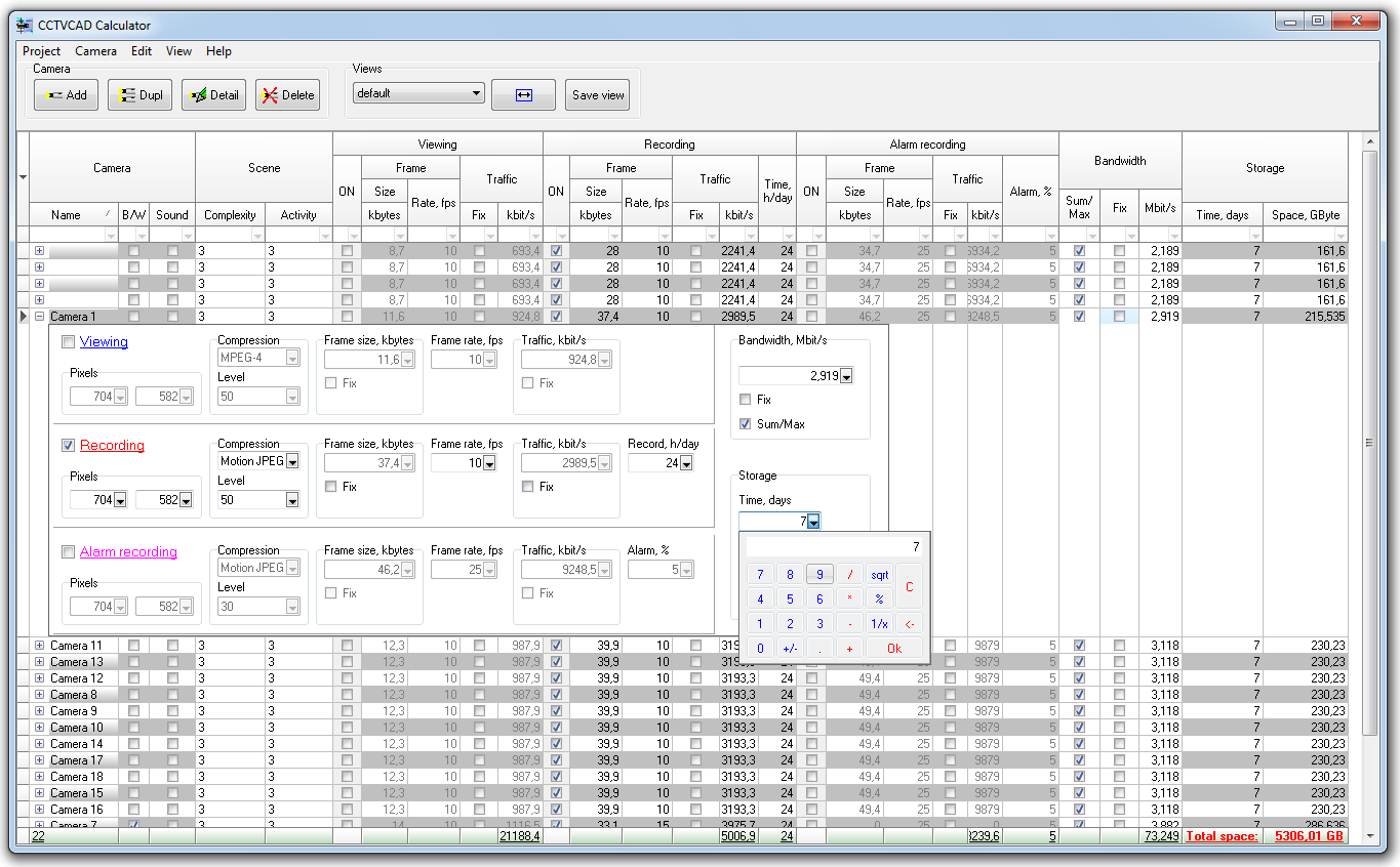

Stanislav 0 Posted June 30, 2010 (edited) See also CCTVCAD Calculator. This calculator uses adjustable patterns based on result of practical measuring traffic for different equipment, compressions, scenes, frame rates, numbers of pixels etc. Thus using it you can systematize practical experience and achieve maximal possible accuracy. In addition the CCTVCAD calculator takes into account up to 3 parallel video streams of each camera (Viewing, Recording, Alarm recording) with different setting. It can import camera data from VideoCAD, can export and print and has many other advanced features. http://www.cctvcad.com/CCTVCAD_Calculator.html Edited March 23, 2011 by Guest Share this post Link to post Share on other sites
