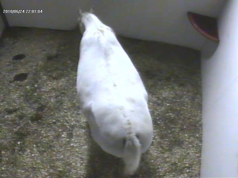

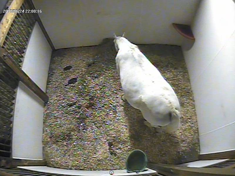

CNB VCM24VF - camera mounted 12 feet above the floor, set up exactly as it came out of the box, lighting is 2 x 80w fluorescent in the adjacent stall - fairly low light but the CNB is still in color mode.
Bottom image is of the same 10' x 12' stall, sscweb14 camera mounted next to the CNB. Fixed 4.6mm lens, no ICR/TDN in fact no way to adjust anything at all. Given a decent amount of light, not a bad camera considering. Both shots captured from AVerMedia system
