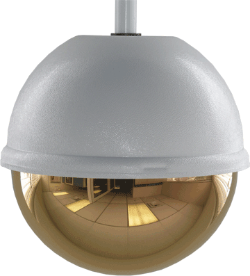

much easier to use mirror effect you dont need to tint. we make are own gold mirror or standard mirror dome covers
