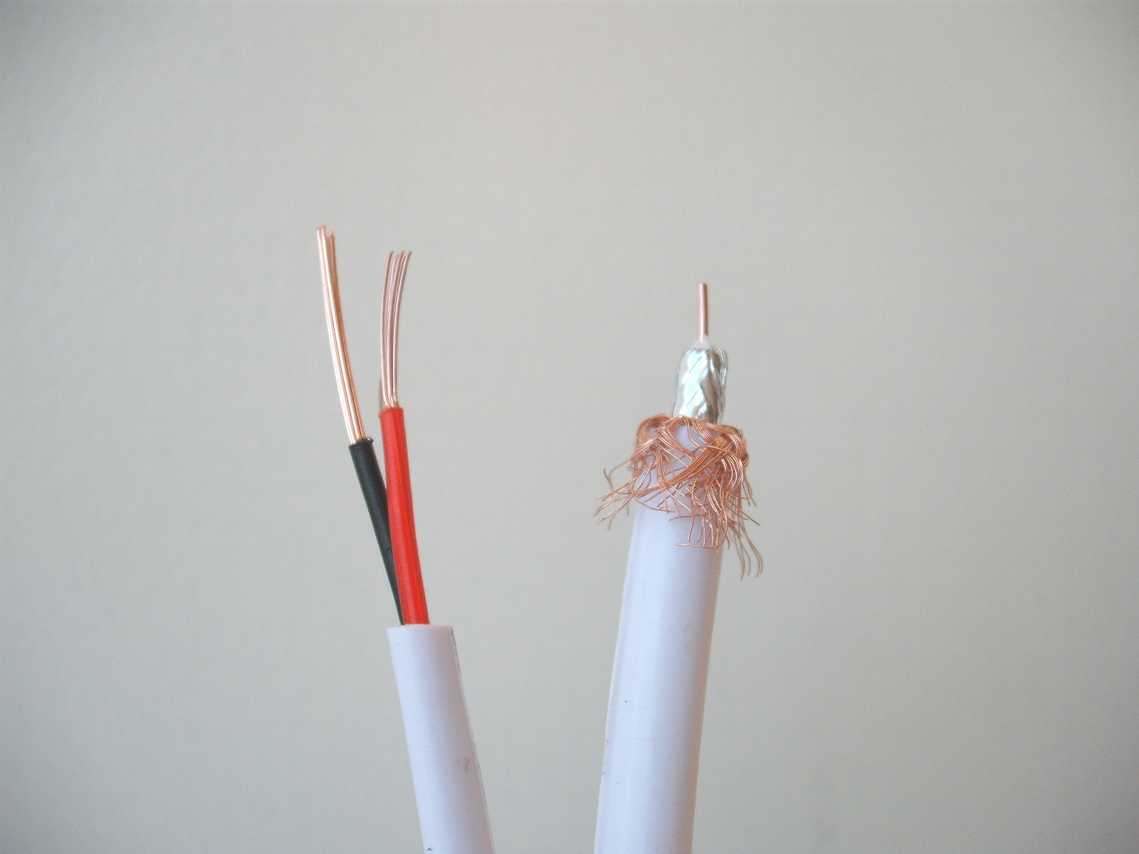

SEANHAWG 1 Posted July 15, 2010 Another question on this: Do you guys prefer to use the cable that has the foil shielding around the white inner part of the coax cable or do you prefer to use the cable that does not have that foil shielding? Share this post Link to post Share on other sites
rory 0 Posted July 15, 2010 foil shielding? do you mean CatTV cable? If so, I have used it in the past when I first started out but its best not to use that, too many issues can arise. Ive changed alot of the old ones out for RG59 now. Share this post Link to post Share on other sites

SEANHAWG 1 Posted July 15, 2010 Hi Rory, Its RG59, here is a pic of what I have: Do you see what I mean about the foil shielding? But I bought some the other day that did not have that silver foil shielding around the inner white part. I do know that if the foil shielding touches the inner conductor, it will kill the video, but I usually peel it back. Should I just use the cable that doesnt have that shielding? Share this post Link to post Share on other sites
rory 0 Posted July 15, 2010 SEANHAWG said: Do you see what I mean about the foil shielding? But I bought some the other day that did not have that silver foil shielding around the inner white part. I do know that if the foil shielding touches the inner conductor, it will kill the video, but I usually peel it back. Should I just use the cable that doesnt have that shielding? yeah get some without that .. ive never seen that before anyway. Share this post Link to post Share on other sites
rory 0 Posted July 16, 2010 BTW if you ask me which I prefer, that type in your photo with the 2 separate jackets joined together, or the single jacket with the coax and 18/2 inside it .. i prefer the 2 separate jackets joined together .. easier to split up between the DVR and the Power supply. Also, you sure they advertised that as CCTV cable? Share this post Link to post Share on other sites
SEANHAWG 1 Posted July 16, 2010 I agree on the 2 seperate jackets. I havent seen any yet with one jacket but I dont really want to either. No sir, they did not advertise it as CCTV but did advertise it as RG59U. It has worked well for us so far but my only gripe was when the foil shielding touched the inner conductor it would screw up the video signal. Its a pain in the butt to have to peel back. Also, the inner conductor was copper clad steel which sucked too. It may be used for cable TV or Satellite TV applications as you said. I have since started ordering rolls from a large cable supplier in California who has great customer service and is knowledgeable in his products. I pay a little more for the cable but it is good piece of mind knowing I get better customer service and better quality cable which will make the end user happier. The cable I get now has a solid copper conductor and doesnt have the foil shielding. I can tell the difference already on our installs. With the other cable, we would have to re-crimp the connections all the time because that stupid foil shielding would touch the conductor. With this cable, we have not had to re-crimp once. I also asked him about using the bare cable outdoors. He basically said if you have it set up in mild climates, you shouldnt have to worry about putting it in conduit as long as you have it pinned against a wall and off of the ground. But on the other hand, if you have extreme climates such as bad icy winters or out in the desert where it is scorchingly hot, it may be a good idea to put it in conduit or he said you can get the direct burial type cable which would stand up to about anything, although I am sure the direct burial type is way more expensive. Share this post Link to post Share on other sites
bulkcctv 0 Posted August 10, 2010 I will say this seeing we sell a lot of cable online. The cable that you are buying for the $125 price you should really look at the spec sheets details. I knew exactly who you were getting from when you showed the AL foil on the inside. The cable that you are buying is what is call CCA (Copper Clad Aluminum). What they do is coat the Aluminum cable with a thin coating of copper. If you had the 100% copper cable and CCA cable next to each other you would most likely not be able to tell the difference just by looking at the cable. The cable that is advertised on E-Bay for $55 including shipping not only is CCA with the AL foil but if you read the spec sheet the 18 AWG 2© is also CCA. So even the power cable is not 100% copper. A lot of the cable on the market place is very misleading and hard actually see the specs. We had to order some of the cheaper cable in just to figure out how people could charge so little for something they were listing as "copper". We import CCTV cable by the container so if you have any questions about CCA just let me know. Also to answer your original question about the outdoor cable. You will want to find a cable with a UV coating on the outside. We did stock it for awhile but there are times of the year (Summer) that the supplies just run out of the true outdoor cable. The normal CCTV cable will work but plan on it lasting 2-5 years. Hope this helps! Share this post Link to post Share on other sites
