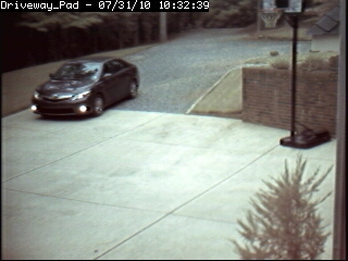

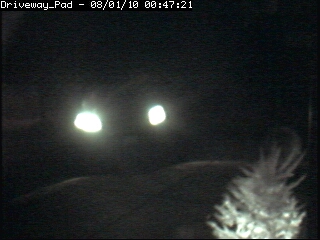

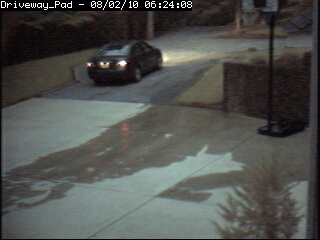

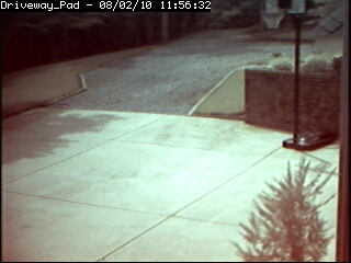

Right now I have the cheap ones outside, viewing my driveway. During the day, they get a red hue from sun glare (they do have sun-guards). At night it's a blackout, they can't see in the dark at all. Finally, the resolution sucks, as you will see in the pictures. I still haven't ever been able to focus them completely. There are normally no lights on in this area.
Please don't laugh at my cheapy cameras
A car driving away at dawn:
Car pulling in during day.
That red sun-glare I was talking about.
A car driving in at night:

In the last picture, I want to be able to SEE that car. And everything else, for that matter. I need a camera that can handle a bright sun on a white driveway pad.

The VMB-24VF is an outdoor vandal dome, IP66 rated. Also it wont "see in the dark" without additional visible or IR light, but it should see in low light as most true day night cameras will.
Your existing cameras are probably color IR cameras with very little IR, and what it does have that little tree there might be blocking as well. Either way the CNB should be much better then that one, even a CNB color IR vandal dome would be better then that one and put our much more IR. With the 24VF you still might need to add light, what is the lighting like there? Not sure how the 24VF will work with car lights, normally need a WDR type of camera for that.

The CNBs are great cameras, but as rory says, they do need SOME light. You could probably leave the old cameras in place and powered and their IR LEDs would provide some illumination (which the CNBs would make better use of than their own cameras).
If Siamese cable is hard to find, or more in the pricey side where you are, you can use standard RG59 or RG6 coax (former preferred - copper core and braided copper shield) for video, and just about anything else for power - 18/2, speaker wire, UTP... we normally use Station-Z wire, four-conductor 22ga. stuff. Siamese is nice for the convenience but tends to cost more, and personally, I find it more of a pain to pull through tight corners.
As far as your resolution problem, that's more a limitation of the DVR. 320x240 is pretty minimal, not even full CIF (352x240).

i just posted up several pics from cheapie cams vs the 24vf in another thread. There is no comparison between the cheapies and the CNB at night. the 24VF can't see in total darkness but it doesn't take alot of light for them to see. I am using 7 watt candle bulb on my garage and it gives enough light to see out to the street. Not clear enough to read a plate number of course but good enough to get a make on the car and can see faces out to 25 feet or so. I am thinking about adding a second 7 watt bulb on the other side of the driveway and then I'll be set.
Thanks for the first-hand input! I think I will go with leaving the 25 watt lights at either side of the garage on. That sounds like it will be plenty.

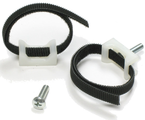

Hey how do you guys fasten, for example, Siamese cabling to a wood stud. Can I just staple with a staple gun between the two jackets, or should I staple across the two (perpendicular)? Maye there's another way?
Anything that uses nails is pretty much limited to wood. Nylon cable saddles can be screwed to wood, steel studs, drywall anchors, hollow-wall anchors, concrete/brick anchors...

I'm thinking the nail/screw goes thru the hole in the center, between the two jackets, and into the wood or whatever. Do you think I could just do that with a nail only?
