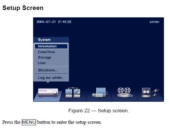

smmorris 0 Posted August 16, 2010 That picture looks exactly like it! Share this post Link to post Share on other sites
rory 0 Posted August 16, 2010 Its also sold by CAPTURE and COSTAR. But must be outdated as cant locate them yet on their sites. Found this though: Capture: CPT-XDR1600 http://www.capturecctv.com/files/pdf/cpt-xdr.pdf Share this post Link to post Share on other sites
rory 0 Posted August 16, 2010 finally http://www.costarvideo.com/downloads/x-seriesusermanual.pdf Note the english menu text in this manual .. should get you somewhere now more: http://www.costarvideo.com/support/support.aspx?id=0 BTW going by the Costar manual, you use the first menu item which is INFORMATION, then there is a drop down to change the language Share this post Link to post Share on other sites
