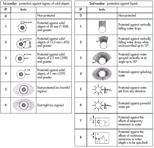

Birdman Adam 0 Posted August 16, 2010 Here's an explanation of IP ratings... Share this post Link to post Share on other sites
