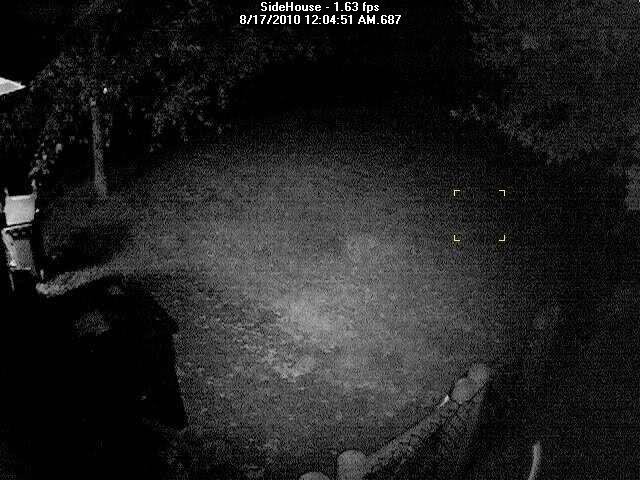

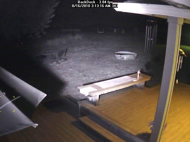

magohn 0 Posted August 16, 2010 Hello all, I purchased the ACTI 1231 after reading excellent reviews on the net. Since installing the camera I have always been majorly disappointed in its night time performance. The lens seems to pick up reflections from the circle of LED's around the camera. I tried tightening the lens cover to make sure the rubber seal that lives around the lens is blocking out any reflections from the LEDs. This made no difference. The camera cost $500. By comparison here is a pic from the ACTI (top) versus a pic from one of those cheap Chinese eBay PTZ cameras ($75). What am I doing wrong? Thanks! ACTI CHEAP PTZ Share this post Link to post Share on other sites
hardwired 0 Posted August 16, 2010 Try getting a sample image with the lens cover off, it still looks like the IR is bleeding over into the lens. Also, make sure the firmware is one of the newer versions, with the imager profile loaded, this does improve low light noise (and a few other things) somewhat. Share this post Link to post Share on other sites
rory 0 Posted August 17, 2010 I dont know, maybe as its megapixel? But more importantly, why does that Ebay camera look so good at night?? Is that IR from the camera itself or is there other light on from the Patio? Is the same exact amount of light present in the snapshot from the Acti camera? Share this post Link to post Share on other sites
Birdman Adam 0 Posted August 17, 2010 I dont think this is a fair comparison...eBay cam gets porch lights. But yea, I think the IR is reflecting through the outer glass cover to the lens...I would maybe disconnect the IR and use an external IR source. Share this post Link to post Share on other sites
magohn 0 Posted August 17, 2010 Thanks for all the suggestions. I will attempt to address a few: AFAIK - I cannot turn off the IR lights on the Acti. I see no option to do this in the latest firmware. Lighting - The eBay cam has an extra LED illuminator as we have a coyote problem and we needed to see across our fields. The Acti is using the stock IR's BUT there is a large "normal" secuity light on that corner in the pic but the Acti is still almost unusable at night. Im most disappointed on the level of reflection into the lens of this Acti - I will try tonight leaving the glass cover off the lens and see how that works. Its warm and dry tonight so a night without the cover on should not do much harm. I guess I just feel that for a $500+ megapixel camera the quality at night is akin to my $25 USB cams I have. Please keep the suggestions coming - much appreciated. Share this post Link to post Share on other sites

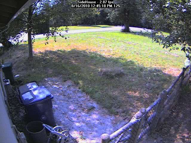

magohn 0 Posted August 17, 2010 Can you post a daytime image please. I would hope the engineers at Acti would match the angle lens to the IR's on the camera. I will post a new night image (without the glass on) as soon as I get one - thanks! Daytime pic of the Acti - Share this post Link to post Share on other sites
rory 0 Posted August 17, 2010 Doesnt look right ^^ Im sure thewireguys or bullwinkle can assist though as ive seen their images and they were much much better. Share this post Link to post Share on other sites

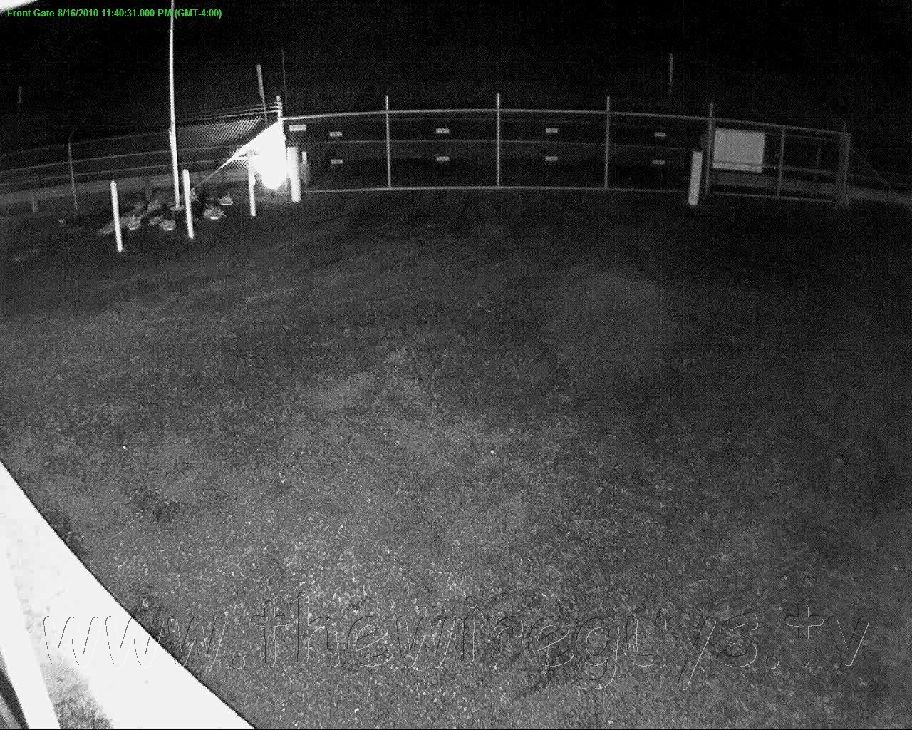

thewireguys 3 Posted August 17, 2010 (edited) I would hope the engineers at Acti would match the angle lens to the IR's on the camera Well it has a var-focal lens so its not possible. Could you post full res images please. What is the compression set to? Can you take a pic of the lens cover and a pic of the lens with the lens cover off? What firmware is in the camera? Edited August 17, 2010 by Guest Share this post Link to post Share on other sites

thewireguys 3 Posted August 17, 2010 Why not Megapixel resolution? Share this post Link to post Share on other sites

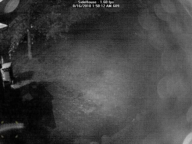

magohn 0 Posted August 17, 2010 Why not Megapixel resolution? Hello, I dont run the camera in megapixel because the other 5 cameras on the network are all 640x480. The CCTV software I am using resozes the viewing window to the resolution of the camera and so if one camera is at a different res than the others, the viewer has to manually resize the viewing window to see the full picture. Here's a pic from last night without the glass cover over the lens - no more IR reflections but still weak quality compared to your excellent shots. I need to figure out why the IR's are reflecting into the lens with the cover on. I have screwed the cover on as tight as possible but the IR's still bleed through. Thanks all. Share this post Link to post Share on other sites

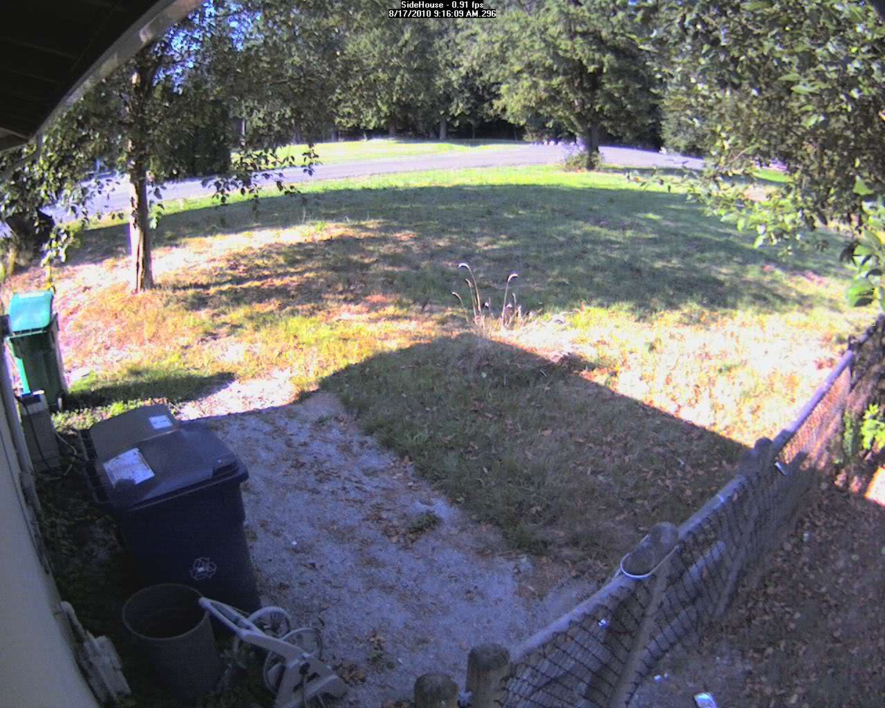

magohn 0 Posted August 17, 2010 ....and a full res picture: Share this post Link to post Share on other sites
SEANHAWG 1 Posted August 17, 2010 Dang, can you get a refund for the $500 and get several of the cheap $75 that do better? It almost makes me think the camera is defective or something. That just doesnt look right. Even right out of the box without any adjustments, you should get way better of a pic than that. Share this post Link to post Share on other sites
