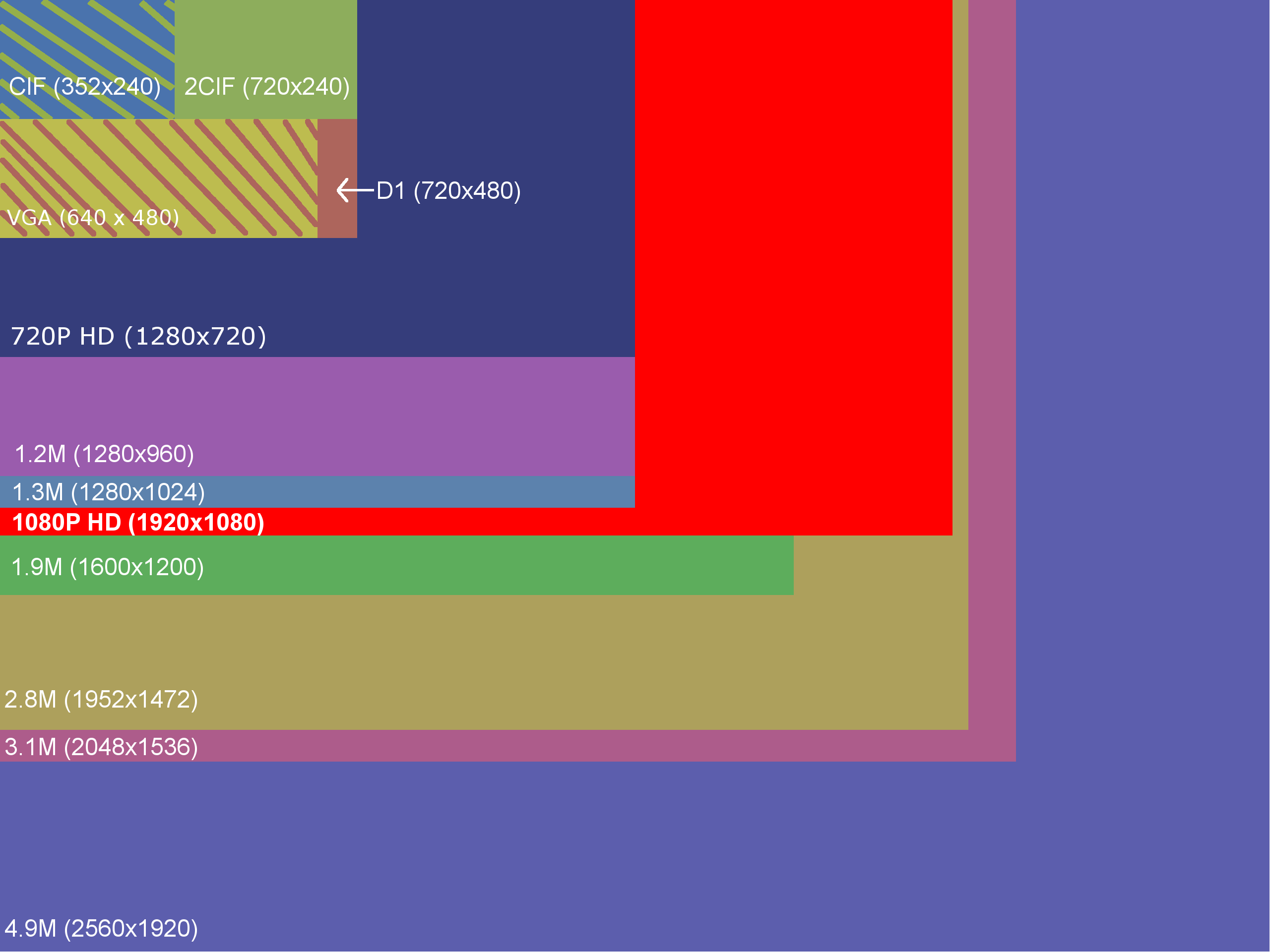

I wouldn't go with a 1.3 or a 2MP if you want to fill up your screen. I would use 720P or 1080P then you will not have bars on the left and right.

sorry, not following. what exactly do you mean by 720p or 1080p? i thought that as long as the camera is capable of having more than 1080x1920 pixels, you could have it display properly on a 1080p tv. am i interpreting this wrong?

720P and 1080P are 16/9 formats just like your TV.
All of the other resolutions are 4/3 which will not fully fill the TV.
A little over-simplified - 1280x1024, for example, is not 4:3. More importantly, "720p" and "1080p" refer to SPECIFIC HDTV standards, and are used improperly *as marketing terms* in almost all cases when applied to CCTV cameras. There are a very few that do true 720p/1080p output via HDMI, and except for those few, the terms really should not be used in relation to surveillance/IP cameras.

i think what "thewireguys" was trying to say is that each cameras MP resolution is dependant on filling the screen per pixel and not "stretched". maybe i misunderstood. in any case i think more than 2MP would do the trick.

Yes you can get a 5 MP camera and it will work but you will have to stretch the image to fill the screen were as a 720P or 1080P will natively full your screen without stretching and will look a lot better.
