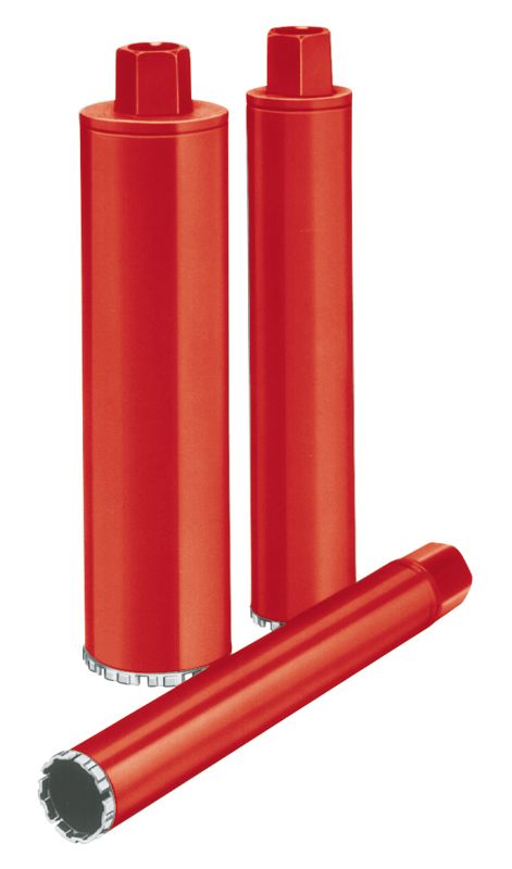

tomcctv 190 Posted September 16, 2010 Been looking for a reason to buy a rotary hammer drill. I'm still not convinced that a couple jobs will justify the expense. I have a Makita hammer drill and was just going to purchase a couple long bits and take stab at it that way. Found some long bits by B&A that should work out ok. The most difficult will be the 4" solid block on the exterior. I should be making the holes large enough to pass a ridgid conduit through but 100% of all the places I serviced so far that has brick or cinder has holes just large enough to pass the cable through. Seems to work just fine this way. When passing the cable into the back of a camera bracket do you folks use a ridgid conduit through the wall or just pass the cable through the hole and seal it? Hi 3RDIGLBL. invest in a core drill set. cut though anything and remember to not drill into any decrative block work if you can help it. its hard to replace. core set. Share this post Link to post Share on other sites
