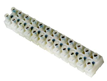

You would have to make sure all these devices run off 12V DC. And then the problem you face is trying to jimmy rig their power cords to your 12V power supply.
That should be no more problem than wiring them into any standard 12V power can. A terminal block designed for car audio installs would facilitate things - something like this:

You can join them anyway you like, beanies, butt splice connectors, terminal strips, tape, whatever .. r adio shack sells everything you need. Eg.

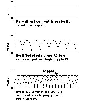

SEANHAWG: what this means is, without proper filtering, the actual voltage output of an AC/DC supply is a bumpy line that will actually vary between the peak voltage (probably upwards of 18V or so) and as low as 0V, 120 times per second, looking much like the second graph below. A capacitor across the supply smooths this ripple, although it won't usually remove it completely. If the 5A supplies don't have sufficient filtering, the result would look... well, like this, but not as bad.
Switching-mode (or pulse-width-modulated) power supplies would look even worse without filtering, as they essentially just flip the full voltage on and off rapidly.
Some devices may have additional filtering on the power input that would mitigate the problem... sounds like these MUXes do not.
