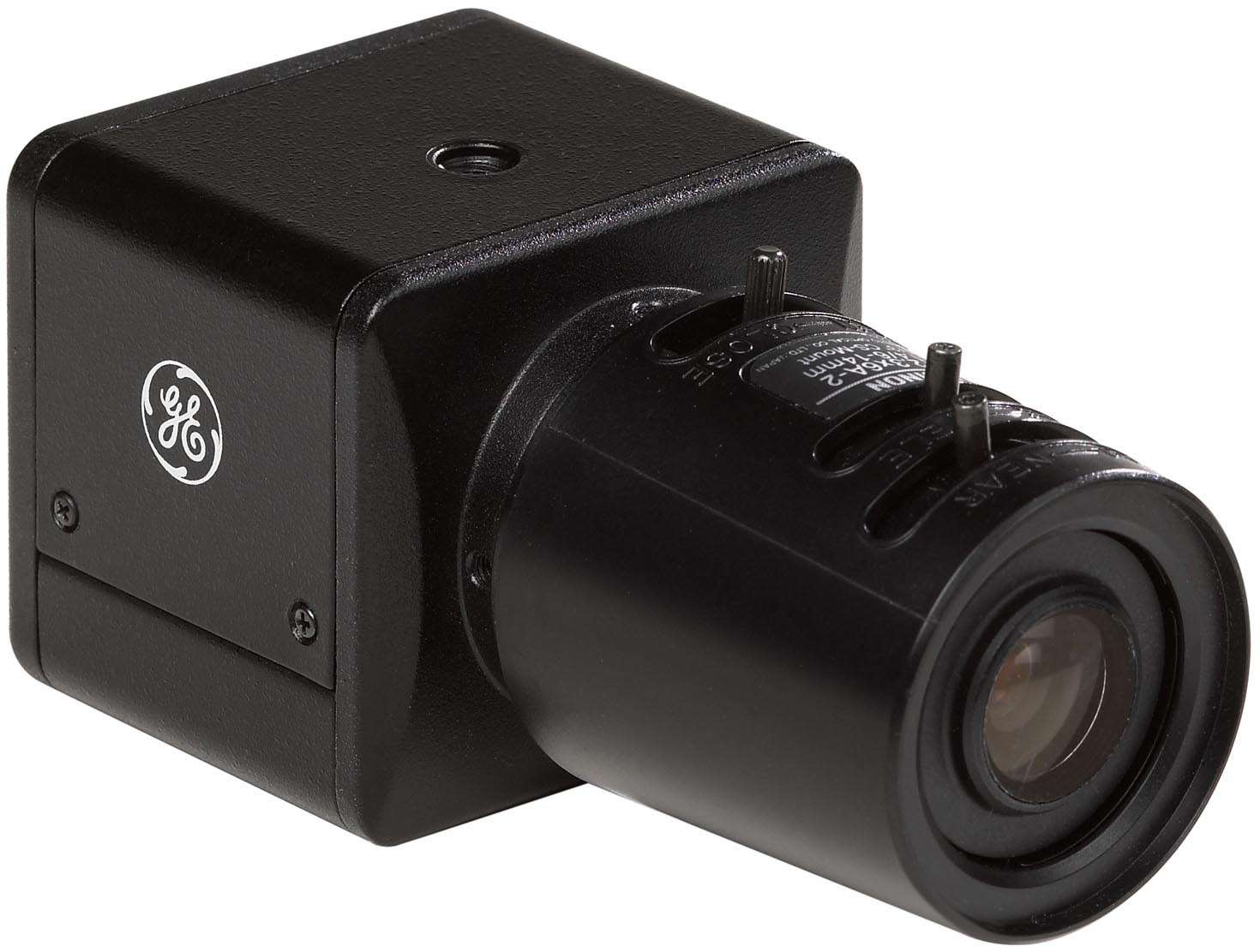

Soundy 1 Posted September 19, 2010 Soundy - The floor is yours! I HAVE NO OPINION ON THE MATTER! But I was wondering, why are the Pelco's so much smaller than pretty much every camera that is in open air, ie AM/PM, 7/11, other banks, etc. Maybe the question should be, why are all the other box cameras so much bigger? They certainly don't need to be these days, except maybe those like the Panny CP484s that cram a whole motorized auto-backfocus assembly in there as well I know with some of the older ones, like the National NLC5500/5700, Panny CP224s and such, they actually have a transformer inside (I've never dug in far enough to see if it's part of the power supply or something to do with balanced video output... I suspect the former). I suspect with newer cameras, it's as much to maintain the "classic" camera look, although I'm sure some of is space for additional processing, power supply, etc. I still haven't done my system yet, but always get the info on every camera I see so I can research it. Most of these guys don't have images or videos for demo purposes, I find that annoying. My experience, the 1370 is pretty good for a small-form-factor camera, although not as good over a broad range of conditions as its larger 3701/3751 brothers. Share this post Link to post Share on other sites
rory 0 Posted September 19, 2010 Nothing new, GE had them for years, Panasonic have them. The ones Ive used get really hot and also dont quite have as good an image. May as well just get a dome. Share this post Link to post Share on other sites
danger_e 0 Posted September 20, 2010 Agreed. Plus, domes are becoming easier and easier to install. I've dealt with some dome cameras that come with a little adapter that's designed for drop ceilings. This means no large pieces of hardware to mount to the wall, the camera just goes right in the drop ceiling and there are no exposed cables. As far as box cameras go, I think that part of the equation might just have to do with public perception. People know and recognize large box cameras as CCTV, and seeing those big cameras may be a large deterrent, at least in convenience stores (I doubt that it's a valid deterrent in banks anymore). Do you guys think that's a valid observation, or am I full of it? Share this post Link to post Share on other sites

survtech 0 Posted October 4, 2010 (edited) The Pelco CCC1300H-2 and its successors, the CCC1370H-2, CCC1380H-6 and now the C10CH-6 are an excellent basic camera that were designed to fit, with lens, in Pelco's DF-5 back boxes. In actuality, the cameras are manufactured by Fujitsu (although Pelco won't admit it). http://www.fujitsu-general.com/global/products/camera/survei/index.html The CCC1300/1370/1380 are basically Fujitsu CG-321N / P. The CCC1390 was a Fujitsu CG-301N / P. The C10CH-6 is a CG-531N / P. The original CCC-series were very popular in casinos, although the DSP functions or chipset differences make the C10CH-6 less popular due to a "raggedness" in the picture that didn't appear on any of the CCC-series cameras. When questioned by our distributor, Fujitsu refused to provide any U.S. sources for the cameras; claiming we had to buy them from their importer but refusing to divulge who that importer is (Pelco, of course). Edited October 4, 2010 by Guest Share this post Link to post Share on other sites

rory 0 Posted October 4, 2010 Panasonic WV-CP254H GE KTC-215CC/240 (discontinued?) Share this post Link to post Share on other sites
survtech 0 Posted October 4, 2010 Panasonic WV-CP254H Rory, The biggest problem with many cameras (including the WV-CP254H) is the lack of a defeatable AGC. According to Panasonic: AGC Level Selector AGC level can be selected with this selector. AGC automatically controls the gain of Image brightness level. HI: This setting raises more the gain and brightness of images under low light conditions. LOW: Normal position Low does not equal off. Even low AGC tends to muddy high contrast images (like playing cards) to the point that values and suits are unrecognizable. Otherwise, it would be an excellent choice, along with the Sanyo cubes: VCC5884E and VCC5884EA and the Ikegami cubes: ICD-505 Watec also makes some very small CS-mount CCTV cameras. The problem is that many of their cameras require odd voltages, like 6VDC, 9VDC, 12VDC or 15VDC. Watec 250D Share this post Link to post Share on other sites
