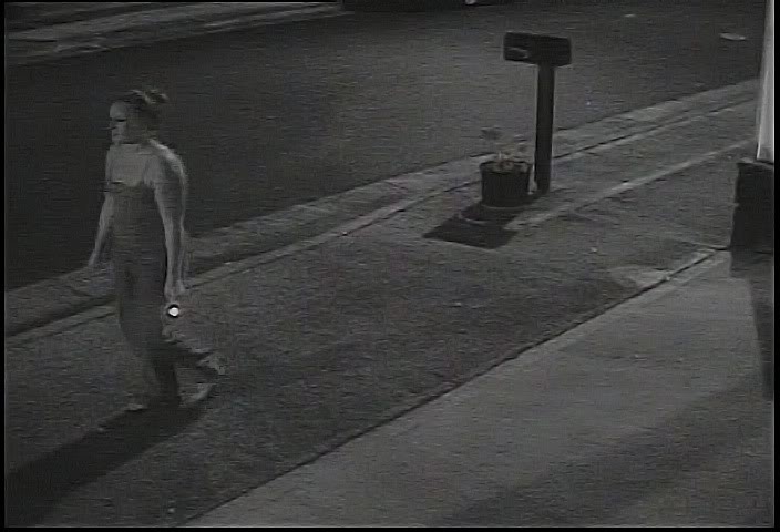

D.V.S. 0 Posted September 26, 2010 (edited) Here's a VBM-24VF still shot at 2:37am, street light behind lady @ 50 feet, street light ahead of lady @ 200 feet, 90% full moon out (was cloudy though), no infrared. Camera gain at 6 (don't like too high gain settings, causes too much noise). Camera is 20 feet from lady, so I would prefer a flood ir not a spot. Don't know if I'm going to add an ir illuminator as I don't like the zombie look. But that adjustable ir beam bantham1 talks about seems like something I could play around with. Taken from a Lorex 20" all in one system @ D1. I know, don't laugh. De-interlaced with vitualdub using avisynth with smart deinterlace filter. This lorex system does not automatically de-interlace. Edited September 26, 2010 by Guest Share this post Link to post Share on other sites

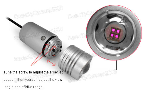

bantham1 0 Posted September 26, 2010 Sorry, can't post the link here. Search ir illuminator on ebay for seller securitycamera2000 and you will find what I am referring to. It is a cylindrical illuminator. You adjust the ir beam by moving the IR element in and out. Works nicely for the price and have had no issues with it burning out so far. I have a 48 led ir illuminator(not using now) and the beam is very tight. That one would be good for a longer pinpoint range ir but it is not good for a wide angle (very narrow beam). Share this post Link to post Share on other sites

CCCmarine 0 Posted October 9, 2010 Is this the Illuminator you guys are discussing? I like the LED array, I have a 900 lumen bike light with an LED array, its amazing for the price. Share this post Link to post Share on other sites
D.V.S. 0 Posted October 9, 2010 Yes that is the one. Don't have one yet though. 900 lumens? Thats brighter than the sun and blinding too! Share this post Link to post Share on other sites
