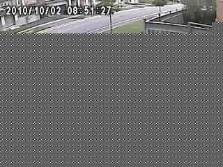

[2010/10/02 08:51:27]MOTION CH3
--lNV0WfexK+l+0rcl
Content-Type: image/jpg; name=ch03.jpg
Content-Disposition: attachment; filename="ch03.jpg"
Content-Transfer-Encoding: base64
/9j/4AAQSkZJRgABAQAAAQABAAD/2wCEABINDAsNEBAOEBIbFRITFBsYGBsdLDlALCApJzZQ
Rz0+OT9DRD1NYUtHV2ZpYVp5WT5FcnNybXyGfVVmhW9ycG4BExQUGxcbNB0dNG5JPklubm5u
bm5ubm5ubm5ubm5ubm5ubm5ubm5ubm5ubm5ubm5ubm5ubm5ubm5ubm5ubm5ubv/AABEIAPAB
QAMBIgACEQEDEQH/xAGiAAABBQEBAQEBAQAAAAAAAAAAAQIDBAUGBwgJCgsQAAIBAwMCBAMF
BQQEAAABfQECAwAEEQUSITFBBhNRYQcicRQygZGhCCNCscEVUtHwJDNicoIJChYXGBkaJSYn
KCkqNDU2Nzg5OkNERUZHSElKU1RVVldYWVpjZGVmZ2hpanN0dXZ3eHl6g4SFhoeIiYqSk5SV
lpeYmZqio6Slpqeoqaqys7S1tre4ubrCw8TFxsfIycrS09TV1tfY2drh4uPk5ebn6Onq8fLz
9PX29/j5+gEAAwEBAQEBAQEBAQAAAAAAAAECAwQFBgcICQoLEQACAQIEBAMEBwUEBAABAncA
AQIDEQQFITEGEkFRB2FxEyIygQgUQpGhscEJIzNS8BVictEKFiQ04SXxFxgZGiYnKCkqNTY3
ODk6Q0RFRkdISUpTVFVWV1hZWmNkZWZnaGlqc3R1dnd4eXqCg4SFhoeIiYqSk5SVlpeYmZqi
o6Slpqeoqaqys7S1tre4ubrCw8TFxsfIycrS09TV1tfY2dri4+Tl5ufo6ery8/T19vf4+fr/
3QAEASz/2gAMAwEAAhEDEQA/ABreONLl5ZGP2eJXdBwOffrVtbewVkijQAy2y3H51VuE451 Invalid Smtp line - should end with CRLF

looks like the base64 is corrupt.
that line with the error, if you leave the "t" but remove the rest, you get the attached image.
it is obviously missing some encoded strings, perhaps just that one line.
so it seems the DVR's SMTP mail program is not encoding the base64 correctly, or its an issue with the source image on the DVR. maybe try an updated firmware?
BTW go here if you want to try it yourself:
http://www.motobit.com/util/base64-decoder-encoder.asp
select decode, and export to binary file, change the extension to .jpg.
