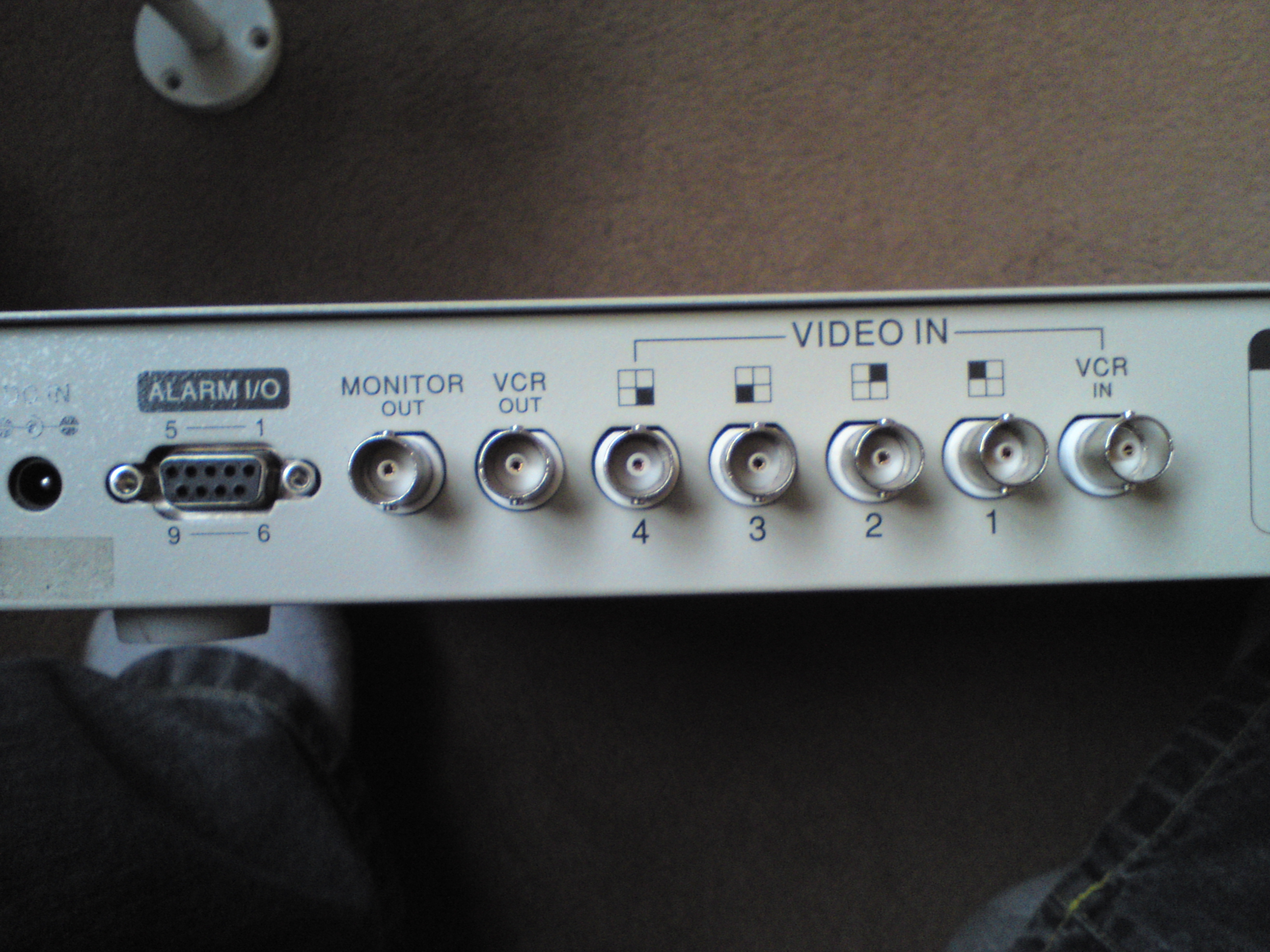

What about the monitor, i want it to go through the vcr but no leads
cheers
Buy a BNC to RCA adapter for the multiplexer to the VCR, and a RCA to VGA adapter for the VCR to the monitor.

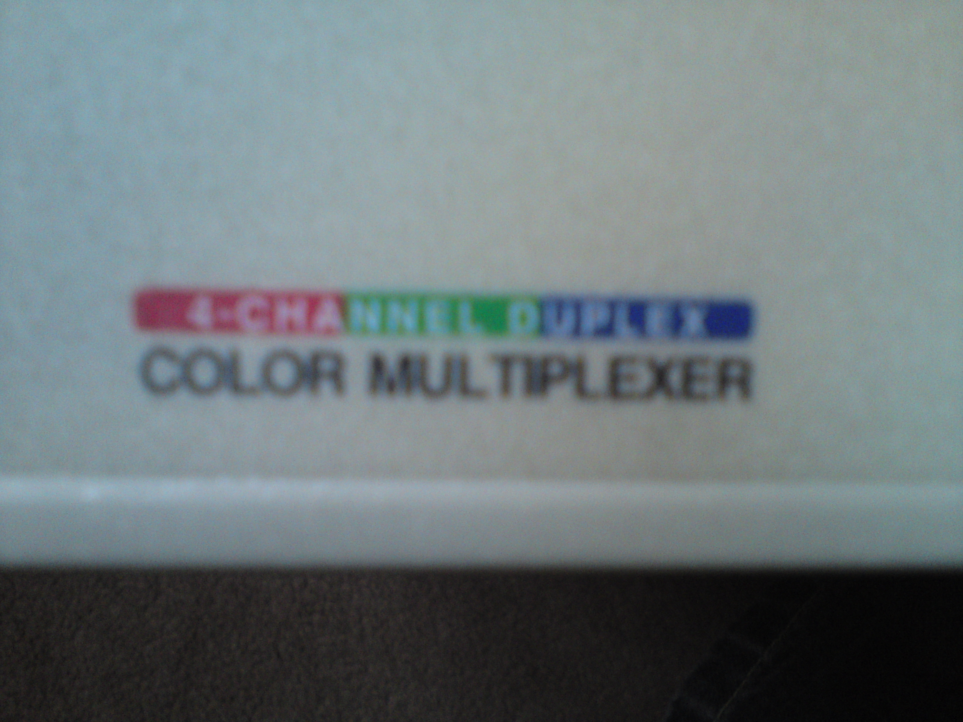

like Tom said... this is not a recorder. in my opinion, does not really qualify as a "cctv system."
what you have is a quad processor. it takes in 4 video inputs, makes a split screen, and shows all 4 simultaneously on a monitor like so:
I am a little confused with this, as you can see in the pic the ALARM port is for a pc monitor and has only 9 little pin holes and the rca leads on ebay have more if you see what i mean, also do i use this for viewing the cameras or the socket that says monitor out?
VCR IN, why would you need to go from that to this
Sorry for sounding dumb but new to this
hi kingy17... the alarm input is not for a monitor. everything is composit so standard tv . the video in is to watch playback. you might be better letting people know were you are you might find a local guy on here who could make up all the leads you need. if you have not used BNC connectors before and you dont have the tool .....you will find it will safe you money just to buy.
Ok thats that cleared up so i would use the monitor out port to the tv, and the vcr out to the vcr to record correct?
A PC VGA monitor uses a 15-pin connector, not 9-pin (unless you're using a very VERY old CGA monitor). That port is for alarm in and/or out connections - some multiplexers (according to the label, this is a multiplexer, not a quad) can output a signal, for example, when motion is detected on a camera, that can switch the VCR to a higher record speed for higher quality.. or may accept an alarm input, like from a motion sensor, that causes the display to switch to an associated camera.
You'll need to connect the VCR OUT jack on the MUX to the VIDEO IN jack on your VCR... *AND* connect the VCR's VIDEO OUT to the VCR IN jack on the MUX. The video recorded on the VCR will likely not be viewable without going through the multiplexer.
Yes, that is correct.
