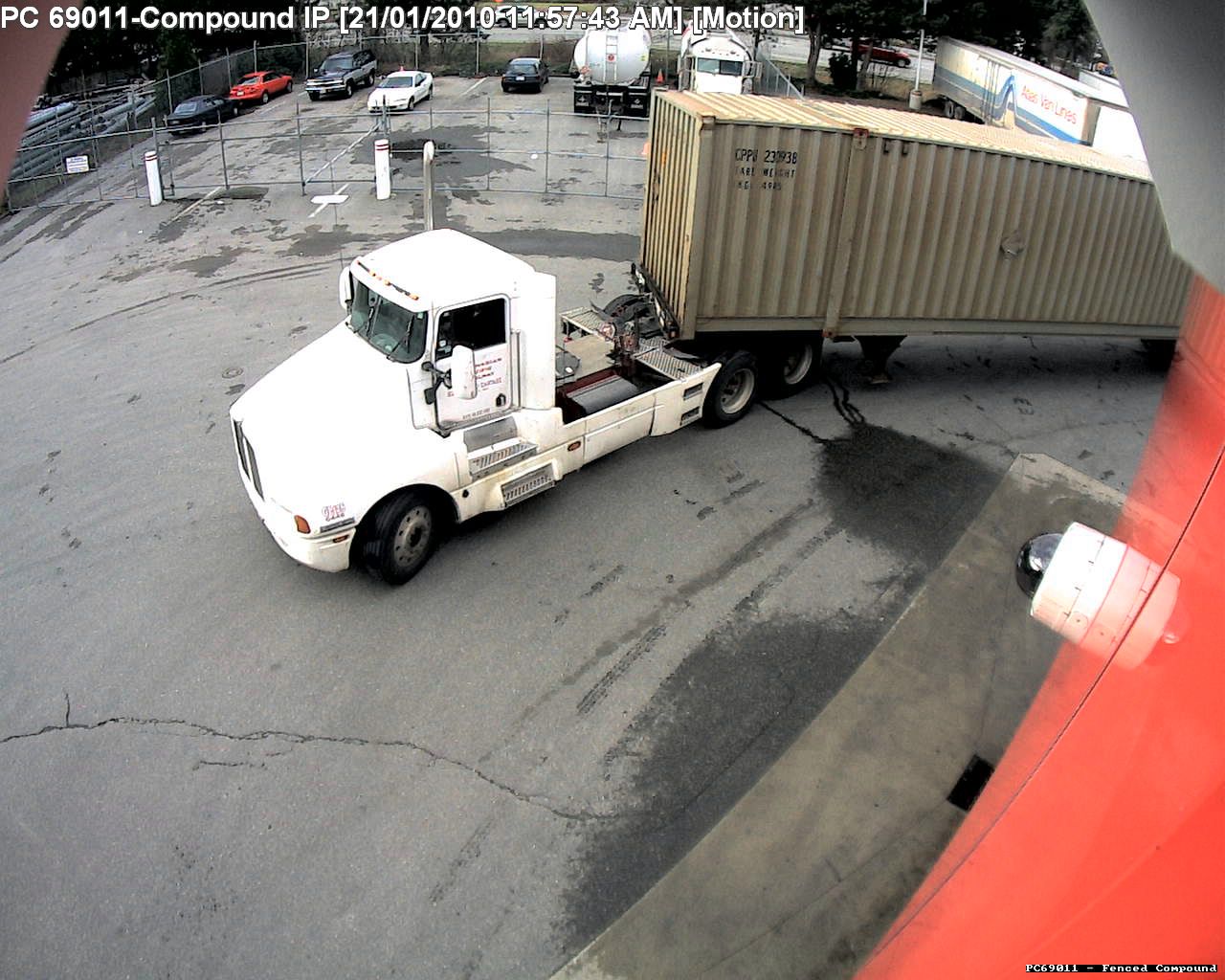

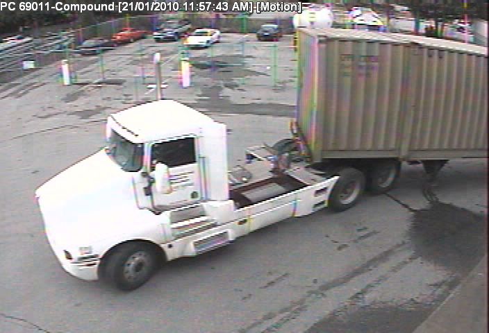

Out of these two images which one does he expect the system to look like?
  thewireguys said:
So he paid north of $1000 for his old system and was not happy with the results and now he wants to spend less and wants better
What does he want? a cheap system or a quality system (pick one)
Definitely the bottom one currently the image above that one is better than the live recording of his current set up.

Sorry of O.T., but, by my opinion, both images is bad...
First image can be better, if you will use encoder with better composite signal color filter
Second, if you will use megapixel camera with better dynamics range
I think the avilgon 16MP would be perfect for that location
Good joke, but not that, what i want to said
For example, Lots of encoders has more better color signal filters, and you will not see "color bars" near image small details.
Megapixel cameras can have more better dynamic range, than in this picture, with the same pixels quantity
