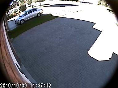

Hi all,
One of my cameras have a "port hole" effect (notice the vignetting on the sides of the photo). Is this due to the lens being the wrong size for the camera?
The camera is a dome type with a 1/3" Sony CCD. Will any M12 type lens fit into the camera or are cameras fussy about the size of the lens?
Thanks.
