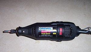

cglaeser 0 Posted October 25, 2010 That is precisely what I did. I disassembled the camera and used a grinder to remove the two dimples that were stamped into the sheet metal posts. Now, the camera will tilt to the horizon. The downside is that the tilt will no longer hold as securely when the tilt nut is tightened, but it is sufficiently secure and will not move once the dome cover is screwed in place. I acquired this camera for the low light performance, and it certainly delivers in that regard. However, the installation features are a bit of a pain. Best, Christopher Share this post Link to post Share on other sites
