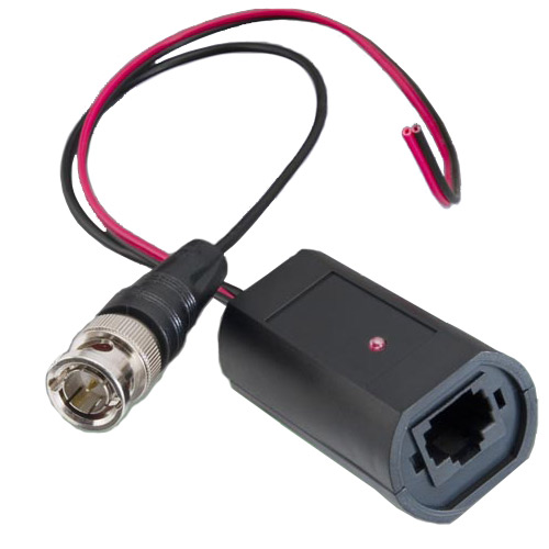

griffonsystems 0 Posted November 23, 2010 i assume he is using passive baluns on each side if this is a analog camera with coax going out to the camera and dvr -- you will have to move to active baluns to boost the signal on a run this long Share this post Link to post Share on other sites
SEANHAWG 1 Posted November 23, 2010 Would I need active's on both ends? Is there a good one that you can recommend that you have worked with? Share this post Link to post Share on other sites
Soundy 1 Posted November 23, 2010 You can probably do it with active at one end (I would guess the sending end would be preferable... frankly, I've never done a run long enough to require active). GEM, GVI, MuxLab and NVT are all brands of passive baluns I've used and trust... Share this post Link to post Share on other sites
SEANHAWG 1 Posted November 23, 2010 Cool, right now he is using Gem Passives. I will take a look at their actives. Thanks. Share this post Link to post Share on other sites

survtech 0 Posted November 26, 2010 1,500 feet is quite a stretch for passive-passive. My balun tests indicated a substantial amount of signal loss at that distance. I would suggest active at one end. Active Receivers: The advantage of active receivers is that they can be located at the recording/monitoring end of the chain, where there is usually easily-accessible power outlets and space for additional equipment. The disadvantage is that it is usually better from a noise standpoint to amplify a signal at its source. Active Transmitters: The advantage of active transmitters is that it amplifies the signal at the source; typically providing a better signal-to-noise ratio. The disadvantage is that the active transmitter has to be located at, or near, the camera; requiring space for the module and a source of power. Share this post Link to post Share on other sites

foresight 0 Posted January 21, 2011 I'd avoid running power over Cat5 at that distance... I'd suggest powering the cameras locally, if possible, and run all four over a single Cat5e run, using active baluns if necessary. Thanks for the recommendation. Which active balun you'd recommend? Thanks For distance, you can use the Active receiver only. Most of time, I recommend under 1,000 feet, Passive Tx +Passive Rx 1,000 to 2,000 feet, Passive Tx +Active Rx. over 2,000 feet, Active Tx+Active Tx Share this post Link to post Share on other sites
hardwired 0 Posted January 21, 2011 I have been using baluns (active and passive) from Nitek for a long time, and been happy with the results. We have a hospital with over 150 channels, with runs between 500 and 2500 feet, using Nitek products for 6+ years. For a 1500' run, the VB37 (passive) at the camera end, and the TR515 (active) at the headend would be appropriate. There are cheaper brands out there, but Nitek (or NVT) have provided the best performance and reliability, in my experience. Share this post Link to post Share on other sites
survtech 0 Posted January 23, 2011 There are cheaper brands out there, but Nitek (or NVT) have provided the best performance and reliability, in my experience. Sorry, but I think NVT and Nitek are hugely overpriced. I did a comparison a few year ago (it's somewhere on this board) and there was less than 1/2 db difference between brands of baluns, including a pair of NVTs. Tests were done at approximately 1,000' and 1,500'. Nitek and NVT tend to be the Monster Cable of baluns. Share this post Link to post Share on other sites
Soundy 1 Posted January 23, 2011 I ran a series of test a while back, a near-full box of Cat5e (probably about 750', still coiled in the box) and a range of passive baluns from cheap ($13/pr.) to high-end ($45 ea.) and several models in between, including NVT, MuxLab, GVI and GEM (basically, all the brands carried by ADI/Burtek), connecting a CNB camera to my Vigil bench DVR... and there was practically no visible difference between any of them. Share this post Link to post Share on other sites
