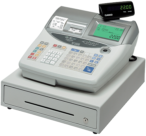

tomcctv 190 Posted December 5, 2010 Kablooie. talk me though how you would get this till to display pos text (decoded) and visable on a screen. then explain how it would be searchable. Share this post Link to post Share on other sites

Kablooie 0 Posted December 5, 2010 tomcctv said: Kablooie. talk me though how you would get this till to display pos text (decoded) and visable on a screen. then explain how it would be searchable. Ha ha ah - I'm not talking about an oversized calculator with a cash drawer. Share this post Link to post Share on other sites
tomcctv 190 Posted December 5, 2010 Kablooie said: tomcctv said: Kablooie. talk me though how you would get this till to display pos text (decoded) and visable on a screen. then explain how it would be searchable. Ha ha ah - I'm not talking about an oversized calculator with a cash drawer. kablooie. that is what we are talking about. a standard till. you are giving advice on back office tills. so its like i said it is cheaper to install a text overlay or swap out his dvr card that does pos. to collect the data from the serial port of his till. Share this post Link to post Share on other sites
Kablooie 0 Posted December 5, 2010 tomcctv said: Kablooie said: tomcctv said: Kablooie. talk me though how you would get this till to display pos text (decoded) and visable on a screen. then explain how it would be searchable. Ha ha ah - I'm not talking about an oversized calculator with a cash drawer. kablooie. that is what we are talking about. a standard till. you are giving advice on back office tills. so its like i said it is cheaper to install a text overlay or swap out his dvr card that does pos. to collect the data from the serial port of his till. Umm, maybe the original post needs to be reviewed again? I guess maybe some information from the original post wasn't fully understood. The topic started out with this: Quote I would like to update the old cash register with a new touch screen one and also would like it to connect it with the cctv system. I'm sorry, but I don't see the touchscreen on that casio calculator. Touchscreen POS systems are typically Windows or Linux based systems, essentially computers with POS software on them. Casio also makes them: Share this post Link to post Share on other sites
