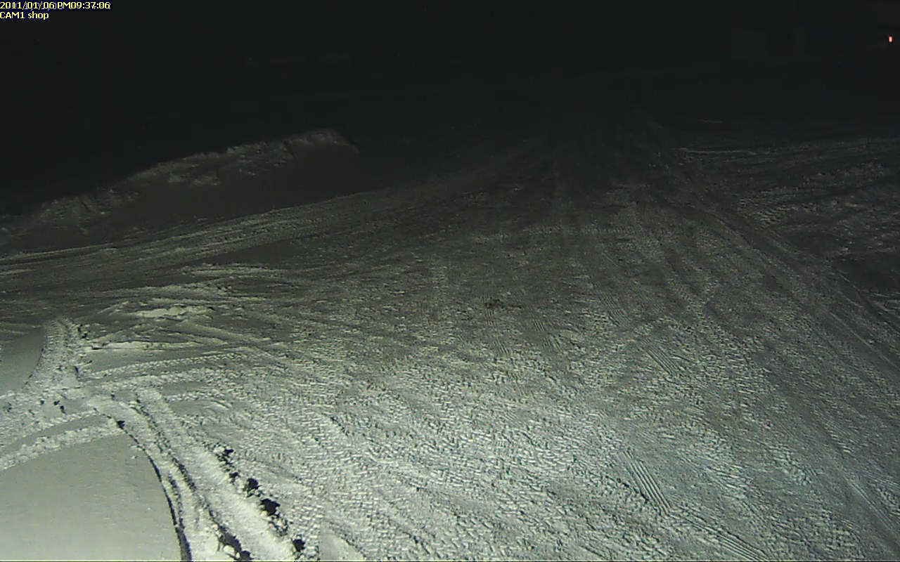

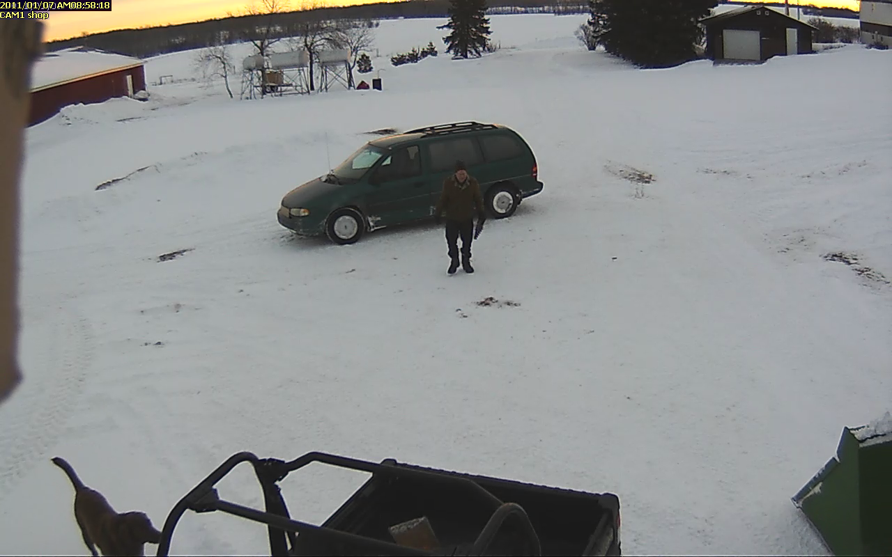

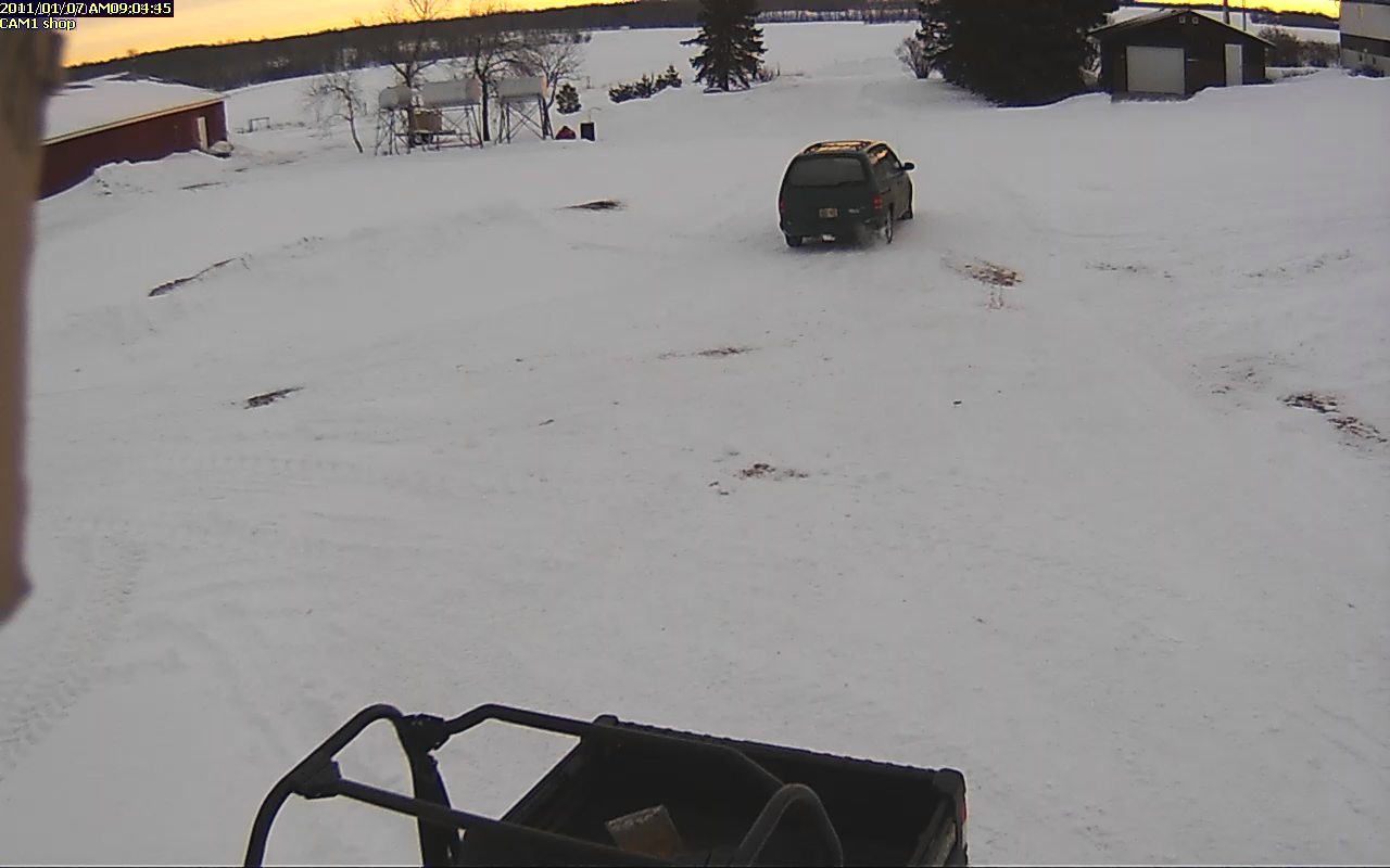

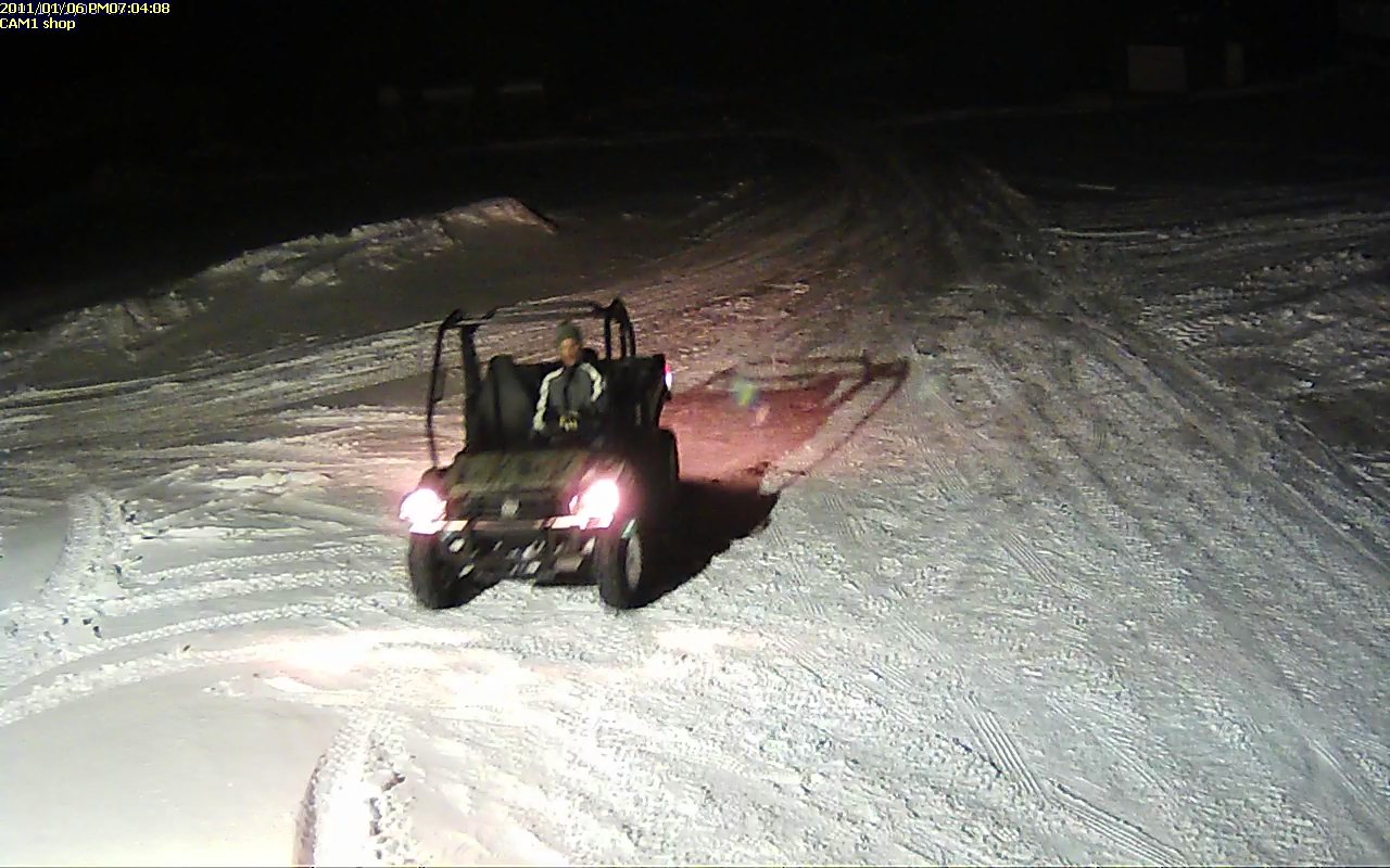

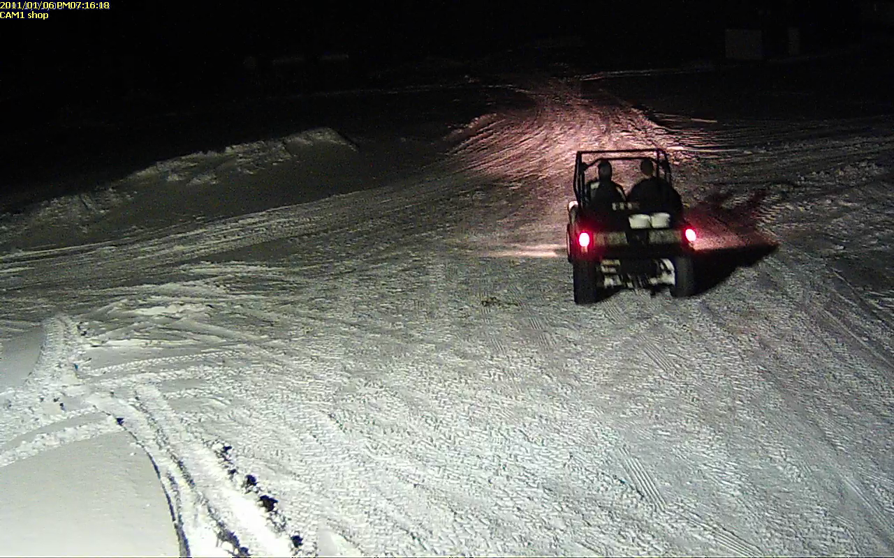

johnnyviper 0 Posted January 8, 2011 Here's some screens off a Vivotek 8332. We've been looking for some cheaper cams for certain applications, and so far I'm not too disappointed. I just quickly set it up, so you'll have to ignore the crooked image and the cardboard flapping! These screens were pulled from a Nuuo 2040 NVR. The camera is mounted about 14' high on the face of a shop at the corner of the building. At the center of the building there is a 250 Watt Metal Halide wall pack. Other than the wall pack there is no other lighting and it was a fairly dark night. Night Shot Moving Face Night Shot Moving Night (Unfortunately no license plate) Moving Day Shot Day Face BTW I will have a Acti TCM-1231 next week to compare to also John Share this post Link to post Share on other sites
bpzle 0 Posted January 8, 2011 John.... WOW. Thank you! Great post. Where did you come from buddy? Lol we need to compare notes! I've used 1231... Have my first Vivotek in test on front porch... Just curious...what was the speed of that Razor/ ATV? Share this post Link to post Share on other sites
Sawbones 0 Posted January 8, 2011 That's better than the Acti 1231... the 1231 tends to blur significantly on motion shots. Share this post Link to post Share on other sites
thewireguys 3 Posted January 8, 2011 Vivotek 8000 > Acti Share this post Link to post Share on other sites
rory 0 Posted January 8, 2011 johnnyviper said: Here's some screens off a Vivotek 8332. We've been looking for some cheaper cams for certain applications, and so far I'm not too disappointed. I just quickly set it up, so you'll have to ignore the crooked image and the cardboard flapping! These screens were pulled from a Nuuo 2040 NVR. The camera is mounted about 14' high on the face of a shop at the corner of the building. At the center of the building there is a 250 Watt Metal Halide wall pack. Other than the wall pack there is no other lighting and it was a fairly dark night. Do you have any shots with it in night mode under low light? Thanks. Share this post Link to post Share on other sites
johnnyviper 0 Posted January 8, 2011 (edited) bpzle: That Gator moving in the shot was probably going about 12 - 15 mph Sawbones: Have you tested the ACTI TCM series, or just the ACMs? A distributor I deal with told me the TCM is a significant upgrade, so I thought it would be worth a try. rory: Unfortunately I don't have any handy on the NVR. I did test it though with the lights out. Wasn't too bad. I'll try get you a couple shots in the next day or two. I just took the camera down last night and put up a Vivotek FD8361. So far it's a huge disappointment. Last night it was a huge blizzard, so there's a chance I didnt' get it focused quite right yet! But at twice the price of the 8332 its looking like the loser. Also, if I remember correctly the "Maximum Exposure Time" was set to 1/15 second. I'll confirm when I get the camera hooked up again. Oh, and the mounting bracket Vivotek sends is a throw away. It's a joke. John Edited January 8, 2011 by Guest Share this post Link to post Share on other sites
