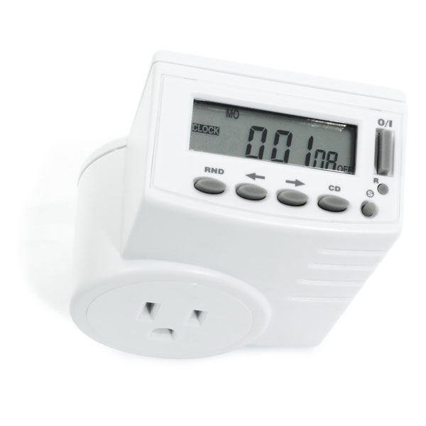

Anyway, how about if you get a basic plug-in household timer, something like this: http://tinyurl.com/37pdz8y
Plug the power for the relay box into that, and set the timer to only turn it on during the hours you want the alarm to be active.

Someone else might be able to suggest another software that will work with the card you have and do what you want. Personally, I think simply putting your siren and/or alarm-box power on a plug-in timer will be far easier and more cost-effective, allowing you to use what you already have. If you need a more complex schedule, just use a better (digital) timer.

that's all correct, can you tell if i don't get it working by software some good digital on/off current shutter or whats it called?
so everything is working. you have the signal from your dvr to your I/O box which on motion detect starts your sounder on and off ................ what you are looking for is a way of just having the sounder start and finish at a set time period
