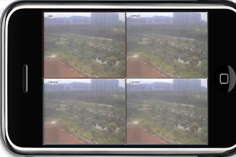

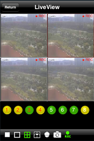

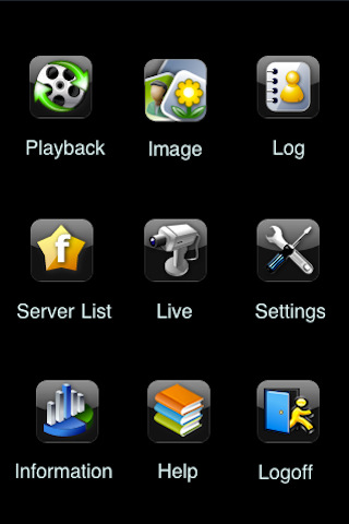

I've only used the iPhone remote viewing app, and The iphone viewing software is pretty nice too. You can only see the low resolution sub stream feed (CIF), but you can see 4-way quad view on the phone, which is nice. It uses SuperCam Pro for iPhone
You can take a snapshot of a camera, record a bit of video directly from a camera to the phone, pretty cool I thought. Rotate sideways gives you a full screen view of either single camera or bigger quad view. Oh and viewing is only for LIVE playback through smartphone. You can NOT review recorded video on the phone, but you can on a pc.
